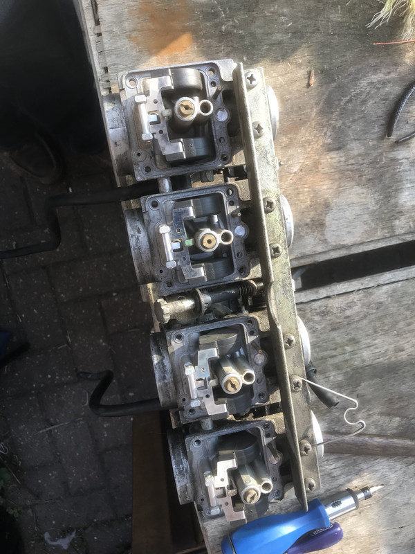

              Well the carbs are out and sitting on the bench.
              1,2,3,4 bodies don't look in any trouble whats so ever. They are clean and good inside.

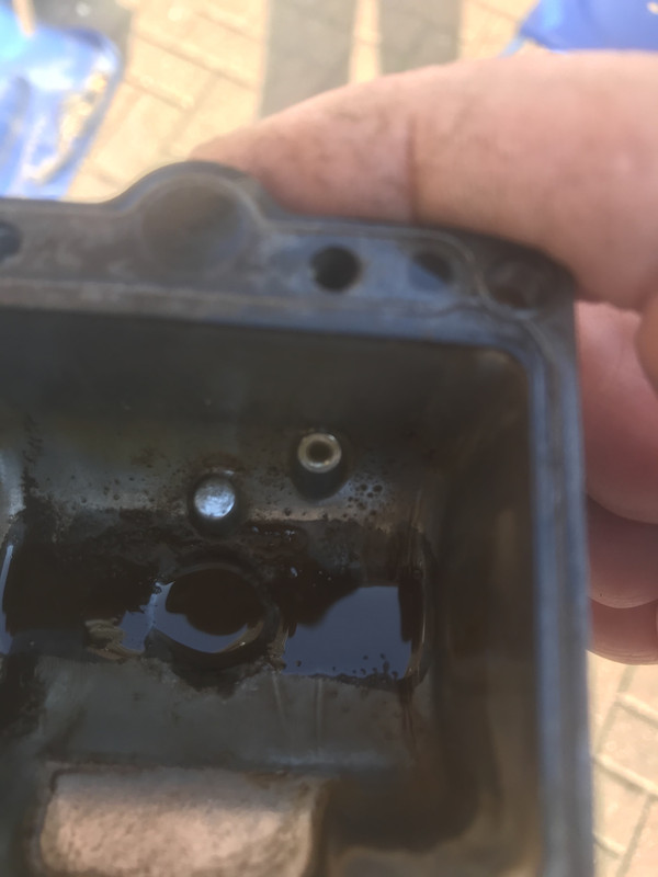

              NO 4 float bowl wasnt great.
              A little soak in fuel and a polishing cloth and its taken the rust and dirt out.
              Sadly the float pins wont budge.
              Mine are shaped with a large head one side and no head the other. I tried pushing them out, pliers and a drift and small hammer but no luck. I'm not going to chance my arm here and shear a post off.
              Had the carbs upside down and blew into the feed line. I can hear air escaping via the feed tubes but I have to lift each of the floats to get anything out so the needles are seating correctly which is nice after all that time.
              So I am a bit stumped now. How much force to get those pins out without breaking the legs off. Another job for tomorrow.

                          Try boiling the carbs before trying to remove the pilot jets. Or, a heat gun. Be sure your screwdriver is an exact fit. Grind one down if necessary
                            Never heard of boiling carbs before. In water or another solution?
                              Tank back together. Fuel gauge sender unit back in with new seal, outer cover with drain catcher, refurbished fuel tap with inner workings and exterior seal and the fuel cap back on.
                              Still waiting on the screwdriver to get at those pilot jets. Maybe tomorrow it will arrive and I can see how good or bad a fit it will be.
                              I'm wondering about how to clean the exterior of the carbs before working on them. I don't have an ultrasonic cleaner so they are not going to go into a warm carb dip all apart. I'I figure that out tomorrow.

                                I boiled my carb bodies with some lemon juice and they came up quite good. Eventually got them vapour blasted for a really nice finish.
                                Be very sure the aperture in the float bowl is clear to allow fuel into the choke chamber and up the little brass pipe.
