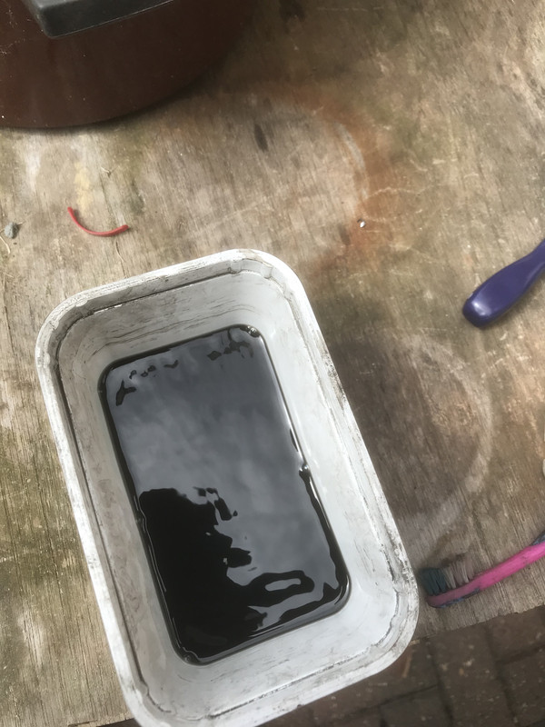

    I boiled my carb bodies with some lemon juice and they came up quite good. Eventually got them vapour blasted for a really nice finish.

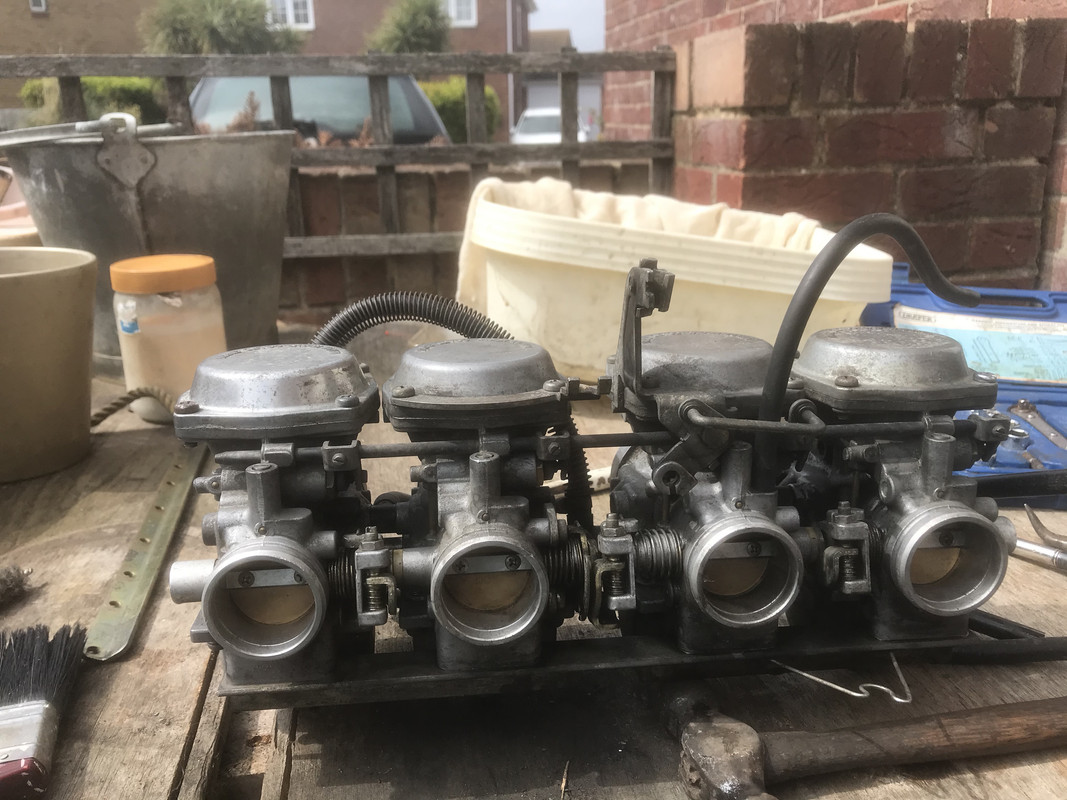

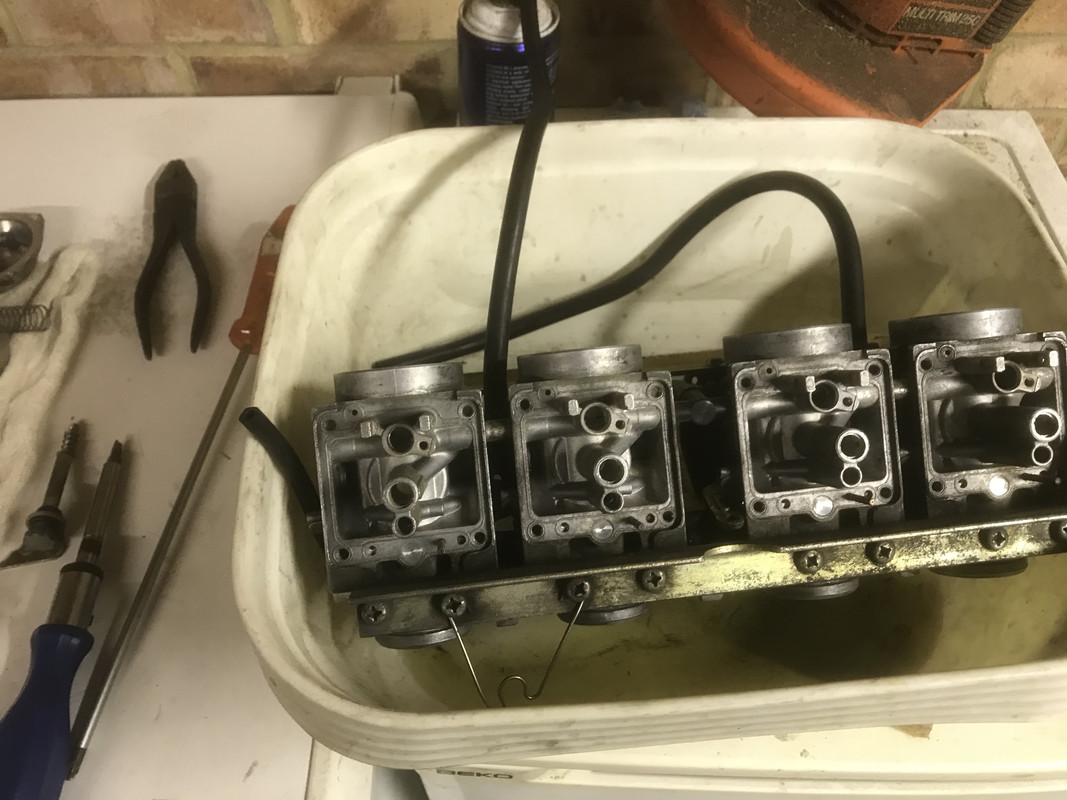

    Spent some time dodging the rain showers and started to pull the carbs apart. Each one individually so tops off, bottoms off main jet out and tube. Dip the brass in some cleaner and then blow it out. Cleaner in the bowls and down the tubes to make sure its all clear.
    Still need to get the pilots out to make sure they are clean and clear for fuel.

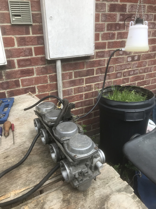

    All seemed OK till I ran fuel back through
    Of course No 4 is the trouble one. Fuel pouring out of the top of the carb bowl (float bowl gasket) and then out the mouth of the carb (float needle not seating.) Seems odd as when you do a blow test the whole lot seems to be air tight in the closed position. The other three appear to be fuel tight.

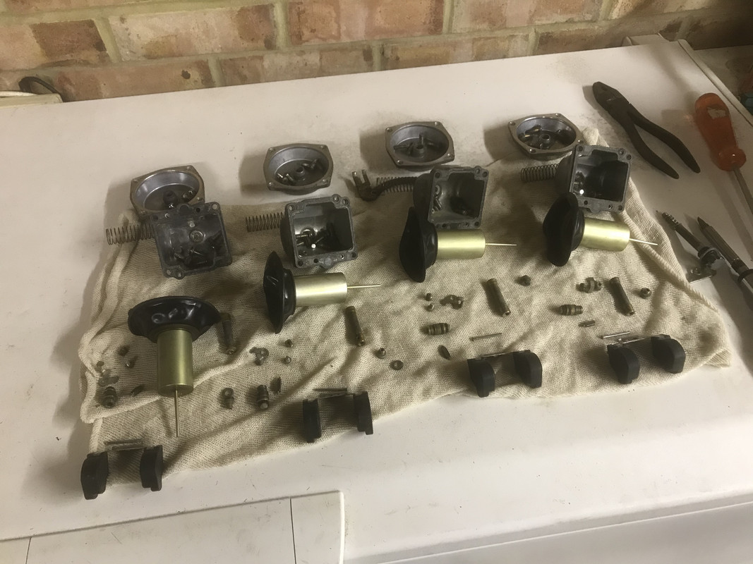

            Spent some time on the carbs this morning and lunch time.
            Pulled No4 apart once again and when I got the needle out found a 2mm strip of a slightly darker line than the bright surface of the rest of the needle. Cleaned the seat and the needle, rebuilt and tested. The carbs held fuel.
            Gave the carbs an exterior clean with a tooth and bottle brush.
            Left side been cleaned and right side uncleaned. Boy, they were dirty on the outsides.

                  Carbs sorted.
                  A 0.8mm x 4.0mm x 100mm screwdriver arrived in the post. Carb bowls off, pilots jets out....
                  2 pilots completely blocked, 1 partially blocked and 1 with only 1 small side hole clear........no wonder she wouldn't run on idle.
                  Into cleaning agent and a blow through with the airline and you can see through all the pilot jet holes.
                  Now back in the carb and ready to go back onto the bike.

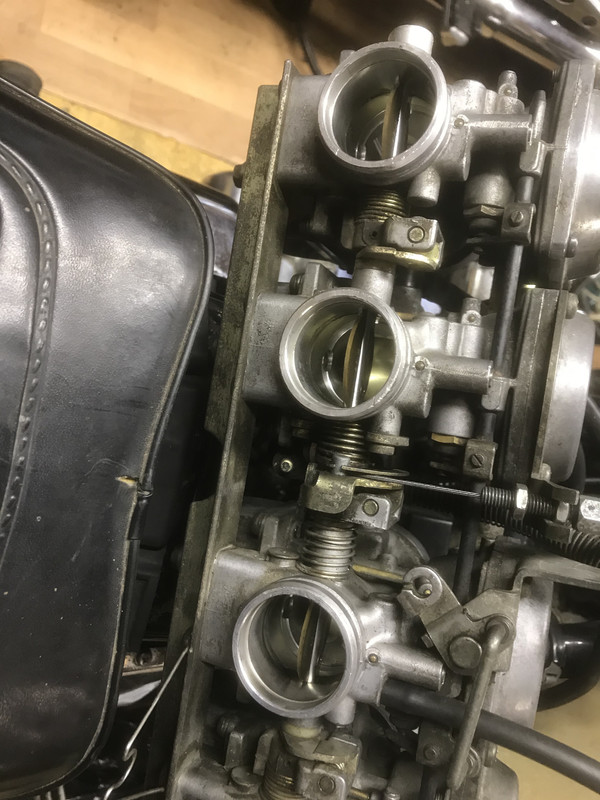

                          OK, what did I do wrong?
                          Still no parts so got bored. What the heck its only a few bolts and screws......
                          And hour later and the carbs are back in the bike, buttoned up and ready to go. Odd thing, the throttle linkages seem very high and theres not a lot of turn on the twist grip from 'tick over' to 'full' throttle....
                          Blocked the vacuum pipe and fitted the external tank for a test....
                          Spun her over and thats all she would give me. No leaks from bowls or overflows but absolutely nothing. Not even a cough.

                            Carbs on the throttle cable. Seem a little bit too open for my thinking..... Full throttle....
                            Full throttle seems a very short twist, less than quarter of a twist from idle to full on. This is Idle. Too far open?
