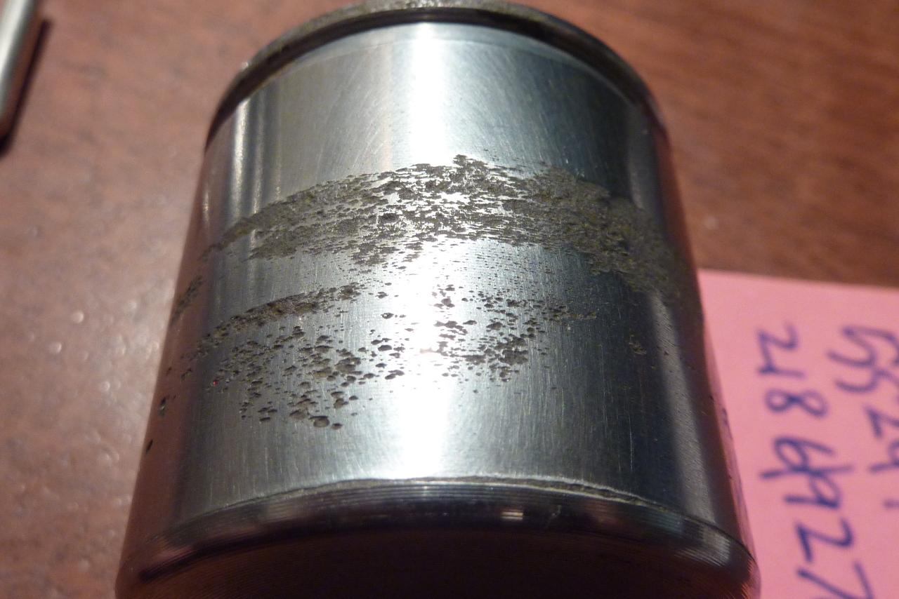

                How do the pistons look? If there is any pitting on the pistons, get the piston kit. (#1 on the fiche.) It will include new pistons, oil seals, dust boots, and the seal in between the calipers (#5). If you don't need the pistons, at least get all new rubber parts.

                  Thanks for the tip on what's exactly in #1, my pistons are pitted and scarred, so I need #1 and #14.

                    If they look anything like this, they are goosed (thank you Tatu):
                    Get some new ones:

                      You might want to consider Stainless steel pistons and never ever worry about pitting again. You can get them here.
