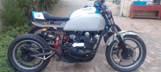

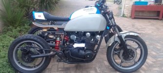

Project has been put on hold till end the month, I bought over one of my friends 1979 750. So i just need to top up the savings first before i continue. Click image for larger version  Name:	IMG-20230210-WA0015.jpg Views:	0 Size:	72.5 KB ID:	1714002
Plans for this month will be to open up the motor making sure everything is in good shape and looking for any parts i need to replace. Im almost done with the subframe design. Still making small adjustments to make sure theres enough space for all the electronics and at the same time make it as small and strong as possible. Ill updates with more photos as i get the small things done.

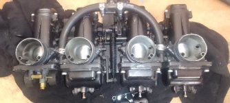

IMG_20230227_121708.jpg this is the carbs for the 850. Dont have a picture of the 750s carbs but almost identical
Those carbs are assembled incorrectly. The air screw bosses are supposed to face the outside of the bike, not inside like shown.
Secondly, Suzuki GS carbs use a center feed fuel inlet, between carbs 2 and 3. The fuel feed as shown is like that of Kawasaki KZ carbs.
Do these carbs have both pilot air screws and pilot fuel screws? If so, they are GS carbs. If they are either air or fuel, but not both, then they are KZ carbs.
Oh, and those carbs use the tiny little fuel Tee's like KZ carbs. They are made from rubber coated zinc. You will need to get a new set, since there are no O-rings on them.

Carbs laying in the garage for now ill examine them on my next off day and add more pictures. Thanks alot for the information this will help alot for when i split them and order the parts. Those are the carbs i got with the bike. Like i said as assembled in the pictures they ran good idled smooth reved clean. Just the leak that came up... the carbs have been standing a solid few years. Thats why i thought maybe it could be a O-ring. Ill uplpad pictures when i split it.
The photos show the fuel screw, but what about an air screw? Do the carbs have those too?

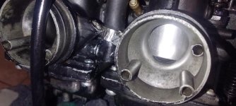

I dont see a air screw on the carbs no. I am wondering what these are for. I havent seen it yet. My 750 also has them. Screenshot_20230314-150801.jpg
