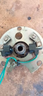

I have this spare that came with the 850 but i cant find anything like it on the internet. Does anyone know what this magnet system is called? Or how it works. Any google links in the right direction would be apreciated. I pluged it in as is but its not working. No spark 16797375936701033702142522706855.jpg

The magnetic signal generators are just one piece of the electronic ignition system. You would need the appropriate rotor, wiring, and of course, an ignitor. Or, buy a Dyna S system and put that in. It might be easier to source some new points and condensers.
