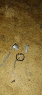

So i finally got a quick moment to split the carbs and get the seal out This is what poped out on the other side the leaking side didnt have anything left. So when it comes to a replacement part. Do i get a o-ring or wont that work.

Will that o ring go over this item or inside the carb. I havent opened the other side IMG_20230316_182953.jpg
That type of fuel Tee doesn't use O-rings, they are built into the coating. If the fit isn't snug in the carb body, you can try soaking them in gasoline to swell them up some. Or, replace them.

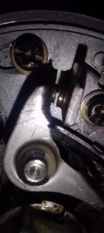

Ive done some quick research but alot of it im still uncertain about. So i let the bike idle. Then i took of the spark plug caps 1 at a time. If i take off cylinder 1 or 4 the bike stops running. If i take of cylinder 2 or 3 she still idles. Heres a picture of the points for plug 2 and 3. First thing i noticed is that its not sitting flush. Second is just some build up but its the same as 1,4 IMG_20230322_214103.jpg

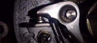

I havent found a service manual yet does anyone know what the gap should be when i have it on the T. The gap on 2,3 is basically double the size of 1,4 IMG_20230322_223458.jpg
IMG_20230322_223843.jpg This is 1,4 on T wich seems the right size gap. I dont want just set 2,3 to the same current gap as 1,4. I dont have a filler guage in the garage so I cant tell what the exact gap is at the moment.

You really need to get a set of feeler gauges. From the side of the pic, the points look like they may be burnt. This could clean up with a point file if it isn't pitted too bad. Looking at the screws, invest in new ones, they are mauled and it will be easier to work on the points if you can use the screws to give a slight tension when adjusting them. Google the gap settings for the points. You should Google everything first before you even ask. This will save you much time, and you can better answers, and your questions will become more involved, unless you fix the problem. Google is your friend when it comes to this stuff. :)
So i fiddled as much as i could from last night almost right through. There was a stage where i had no spark then i got spark back on 1 and 4 now ive got spark on all 4 but weak spark on the 1 cylinder. Took her for a test run. She can rev till 6000rpm but still has no power.
So i got the feeler guage and set it to the correct gap. There was slight spark coming of the 1 point but once i set it correctly no more of that. By slight spark i mean it was still arching and didnt send spark to the plug*
