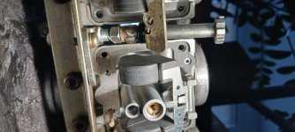

Today at lunch: I decided to try and drop the bowls to check out the jet situation. I got through 1 bowl and two drain plugs before I realized I needed a better way to access the inside float screws. I removed the plug on the #1 carb - fuel flowed out as expected. Dropped the bowl. Bowl looked overall clean, but there was a chunk of flat, solid green schmutz rolling around in the bowl. At first it looked like a piece of gasket, but based on the curvature it looks more like gasoline deposits that formed on the inside of the bowl and then broke free. Which means there's probably more of it somewhere in the carb itself. Oh joy. See picture #1 for this. Removed the cap on the pilot screw, sprayed carb cleaner up the pilot and main jet, waited a couple minutes, dried it off with canned air.

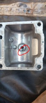

maybe the tinest fraction better. Turned the petcock from reserve to prime - no change whatsoever. Turned the engine off. Shot WD40 into what I presume are the vent holes on the gas cap - see picture 2 - it came out as expected, no dirt/grime/etc. Put the cap back on.
