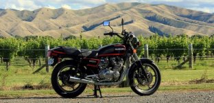

second ride Christmas day. Grape growing region and every spare piece of land has got grape vines on it.
Found some poppies I thought would make a good backdrop to the GS650E. 27-12-22.

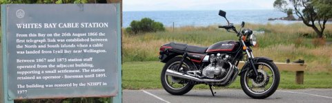

Important historical area. First telegraph link between the South Island and North Island
