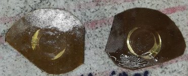

One thing I noticed yesterday when attacking this, is that the reversed "half-moon" rubber seals that I tried are not worn when the clacking began to come back. They are dished. So, after thinking about it, I decided if it isn't simple I won't do it.
Therefore, I've decided this should work: simply brass sheet cut to fit. I reason there's nowhere they can go so they are not attached to anything. Merely shaped to fit the casing.(next post) This is the test fit, dropping the valve cover down.
Note the handy feeler-template tool. But I further "reason" that they needn't be a fancy fit. Note the bloody rag. (Sheet metal is more fun without gloves!) Fingers crossed, are not shown.
4 cut, all the same shape on the 650. Brass sheet is about a mm thick.
Doesn't bind at all turning by hand and a short run didn't result in grinding or screaming noises. It'll take awhile before I can really say how good or bad an idea it is...

Bike on the road again...working pretty well so far. Haven't opened up and looked at it yet but rides fine and quiet.
RIGHT SIDE Cam-end shims..Definitely scored by the right side camend's notches- not a lot, but I think the two thicknesses together are too much when engine run to full temp..? ... they are moving up and down a little too... I sort of expected the increased gouging from the notches. I took THESE out .The left side ones (above) stay in. Seems quiet with just them alone. The experiment continues...Possibly, a shim of some material could be slipped behind them, should these prove to clatter.
