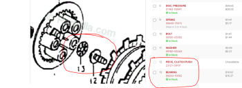

Please correct me if I'm wrong here... but this is the breakdown and it shows the rod #11 going through the clutch assy and contacting the pressure plate #8 - sorry tried to make it larger.

You are correct, the push rod does push the pressure plate. But on my bike the rod doesn't seem to be applying any force to the pressure plate. Is it possible that my rod is broken?
It is possible. However, the only rods I've seen broken have been because of a chain issue. Purchased a 95 Katana 750 and this was what I found. I made a replacement out of a cheap broken screwdriver as it was the perfect size.

Also - make sure these aren't damaged and in place correctly.
The pressure plate isn't damaged where the bearing contacts it.
