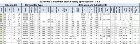

beautiful will use all this info and report back. thank you everyone and pete for saving me with that chart.

No worries, hope it helps! I've come to be suspicious of all spec's listed in Haynes and Clymer manuals after find a couple of incorrect torque spec's and other minor discrepancies. They're great for helpful hints on dismantling etc. but I always go to the factory source for spec's.
after searching around for a legit suzuki manual its a little confusing which is which. from the looks of what google images pulls up, i actually have the factory manual. but apparently not because mine says the float height should be 22.4. maybe the problem is there are many different manuals for different sub-models which carbs are actually a little different.
