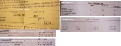

Can anyone tell the capacity of this tank by looking at it? I got 130 miles from F to E at about 42 MPG and refilled 3.2 gallons. There was definitely fuel left in the tank and I rotated the valve to RES to avoid a stall, so I hadn't yet run out of main tank gas, but I don't think there was enough fuel left to add up to 5.8 Gallons capacity. So, what gives? The manuals tell me the '83 GS850L should have 5.8 gallons capacity. I take the gauge reading as a rough estimate but in this case it would be very very rough if E means just under half full. But the tank didn't look half full.
Visually, is there an obvious detail on a tank with 5.8 gallons?
I'll drain the tank into a known amount reservoir eventually but in the meantime I thought someone could identify the tank capacity based on sight.

Shoot, there are so many letter differences with these GS bikes that I was looking at the gs850G specs. Even the chart has 5.8 gallons as the capacity but the review itself clarifies... The L model, which is what I own, has a 4 gallon tank. 3.4 gallons in main, 0.6 gallons in reserve. That would correspond to what I saw in the tank. So, about 170 miles total between gas stops. Good to know.
I dug through all my manuals and made a photo montage of the different listed capacities. Definitely confusing with all these letters. That Cycle World review from '82 isn't completely accurate either. There isn't an even 4.0 gallon tank capacity in any of the literature. 4.5 gallons, yes, but not a 4.0 gallon. So, what I'm guessing is this GS850L has a 3.9 gallon main tank with a .6 reserve or if I go by the owner's manual that suggests there is 4 liters in the reserve then it's 3.5 gallons main with 1 gallon in reserve.

We have an assortment of G and GL tanks in our stable (see signature). The 850G and 1000G tanks are identical and are rated at 5.8 gallons. I have not actually drained them and refilled at a pump to measure, but have no reason to doubt that.
My wife's 82 850GL has a tank that is virtually identical to your '83. The rated capacity is 4.5 gallons (not 4.0). Miles on the tank will depend on how you ride, especially how fast you ride. Best fuel mileage will be below 70 MPH, with a sweet spot of 60-65 MPH. We usually hit REServe about 140 (or more) miles into the ride. By the time we finally stop for fuel, we will put in about 3.5-3.9 gallons.
Average fuel consumption hovers in the low- to mid-40s, but we have had multiple tanks well over 50 MPG when the conditions were just right. And, ... this is experience from living with the bike since the spring of 2005. :encouragement:
Thanks for the confirmation. 4.5 Gallons total. 3.3 as main with 1.2 gallons as reserve is what I'm looking at for the '83 GS850L. That would get me approx. 200 miles total. There are a few places in north america that will be cutting it close (Winnemucca to Adel, for example) but in general that should be enough fuel for my purposes. The bike is dreamy to ride at 65...4800rpm. Dreamy. light as a feather. I wouldn't change a thing. The windshield is a new feature for me but I imagine it doesn't help with gas mileage. It creates a negative air space that actually draws me forward. But the wind impact at 60mph and the feeling of being left behind as I accelerated as the wind pushed me backwards is something I don't miss. Would I take off the windshield for slightly better mileage? Probably not. I really like it. It blocks bugs, rocks, wind. makes the whole riding experience less of a struggle. In Oregon, I once caught a bat inside my jacket at night. That thing would've bounced off the windshield and saved me some panic. A cruise control unit on the throttle might be nice on my wrist. and maybe a floorboard. This bike lives up to the good reputation it has. It fits me well.
You tend to live life a little closer to the edge than I usually do. 3.2 gallons at 45 MPG will get you 144 miles. The 1.2 gallons in REServe might theoretically get you another 54 miles, but I would not go much farther than the next available station after switching to REServe.

On MY GS850GL from 1983 I am usually getting onto the reserve around 135-140 miles -
That eats up about 3.3 gallons - with approx 1 gallon (not proven) reserve that comes up to the 4.5 gallons -
My AVERAGE fuel economy is typically 40ish MPG +/- a little bit -
I have seen as low as 35 mpg at 75 mph and as high as 47 MPG at the sweet spot speeds Steve talks about --
