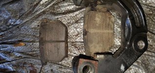

How do these brake pads look?

Should I replace all the brake pads? These are from the front brake, I haven't disassembled the rear brake yet.20200216_162806.jpg
Go ahead and replace them, since you've already got them off. Brake pads aren't expensive, and those are done.
A head-on shot like that makes it hard to judge the depth of the groove, but it doesn't look all that deep.
I agree with zuluwiz, it's time for new ones. :encouragement:
when they're worn down to the slot in the center (or one of them is), it's time to change them. The one on the right is there. Change them.
Also, if they're original 40 year old brake pads, that's another reason to replace them. They weren't that great to begin with, modern brake pad compounds are much better, and the passage of time makes them even harder.
And yeah, those are toast, no matter how new they are.
The answer to every "should I replace this decades-old consumable item" question is "yes".
ZPS, I know that you're trying to be budget conscience, but please believe bwringer's statement: "The answer to every "should I replace this decades-old consumable item" question is "yes". This includes the tires, (brought up in another thread), the brake pads, and not mentioned yet (that I know of) BRAKE LINES. Many threads on the site about how to build them, or who to buy them from. My personal experience with this was only one time. I bought from Venhill USA. One SS brake line w/ banjo bolts/copper washers, and swivel fittings at each end cost me roughty $50. I'm very happy with it. You will need to pay attention to the thread pitch of the banjo bolt you use at the MC if you've changed it from stock, I think you have. Another thread of yours shows a new MC with a gray banjo that appears to be 10mm x 1.25. The rest of your bike, if original, is probably 10mm x 1.00. Other things you may consider are rebuilding the brake calipers w/new seals/everything rubber in each. You'll want to at least inspect the caliper pistons for pitting. There are great tutorials on BikeCliff's website for rebuilding calipers.
But before any of this stuff, get the bike running. Don't spend any money on anything until the bike is running.

When I acquired the Ratzuki several years ago, one of the things that needed doing was to rebuild the brakes. (One of quite a few things, actually) I didn't do the work myself, as I wouldn't have trusted the work if I did it. The mechanic I found to do it replaced the master cylinder and brake lines, and rebuilt the calipers. Then he put the old hard original metallic pads back in. I hadn't told him to replace the pads so he didn't. After taking it out for a ride I found that the brakes were marginal, and didn't even sweep the whole disc. Went right back and asked him to put some newer organic type pads on. This made the difference. The brakes are much better than they were with the old pads on, and I am much more confident riding it. I suppose I could have left the old pads on and gotten maybe 20k more miles out of them, but it wouldn't have been good for my peace of mind. Some things are not worth trying to save a couple of dollars on.
