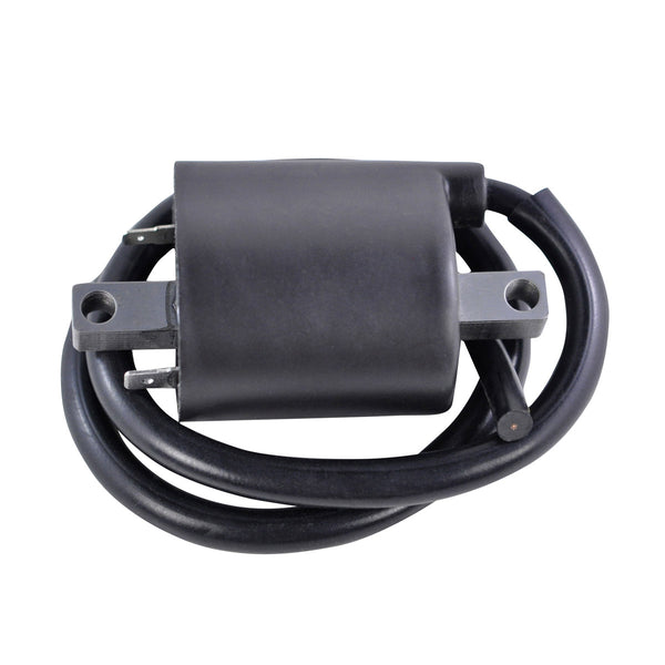

It took a couple of weeks of research, but I think I finally found some suitable coils! The mounting points should even match the stock units. I'm ordering them now - I'll post again once they're delivered, installed, and tested.
RMStator p/n: RM06168
For posterity, these coils are intended for a '99 to '09 Yamaha VStar 1100.
The new coils came in today - they fit perfectly! You'd never know that they weren't stock. Straight bolt-in replacement, with no modifications necessary. The only difference is which end the spark plug lead comes out from, and that doesn't have any effect on anything.

That looks like a good find! I did a lot of searching recently for coils for both of my non-Suzukis, and prob would have gone with them had I found 'em. One is a '74 Laverda triple that uses a single output and a dual. I'm upgrading the ignition, and the original Bosch are not suitable. The other is a dual-output 12V on my Norton, which had a Tri-Spark that heat-sunk after only 2K miles. TEK looked like a possible way, they are often used replacements for Suzuki, came on GoldWing 1200s and other bikes I think. In the end I got 4into1 Dyna copies, similarly priced to yours, and the Norton's running great. Soon I'll attack the Laverda. The 4into1 knockoffs are 3-ohm; that is at the bottom range of what my Norton's Wassell Vape ignition specifies. All seems good. The symptoms on the Norton were classic heat-sink, cutting out when hot, and starting fine when cold. I didn't want to spend a lot of money on an expensive coil, only to learn it's something else. Brings up throwing good money after bad, being cheap, and chucking the dice thoughts. Anyway, I bought what I thought was a quality coil which didn't work out for me the first time with the Tri-Spark. Good luck.
Well..........I ordered a set of the RM Stator coils for my '78 GS1000E project and they do not fit! The mounting bolts are way off, so back they go!
I have to say they made the return very easy. Emailed me a shipping label and I received a full refund the day they got them back!
