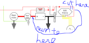

Okay, one more time:
Let's say the R/R is charging the battery..
What keeps the R/R supplied current from by passing that fuse
and going straight to the headlight circuit?
image.png - Click image for larger version  Name:	image.png Views:	0 Size:	17.2 KB ID:	1743950
Sorry for my crude pointer
I'm still a clutz at this computer stuffs..​
My mistake
that red wire goes to the ignition switch, not the headlight circuit.
From there it feeds a number of circuits..
Here is what I would do/recommend:
That way those other circuits will be protected by a fuse.​
In your drawing the r/r is unfused so if anything should happen, it'll damage the battery (or worse). I more or less copied the original diagram on how to hook up the r/r and even though that diagram has it's own set of flaws, I believe the setup is equal to most UJM.
Of course I could just place another fuse in between the circuit that you drew, you might've already had that in mind as well. So you definitely have a point. After all: redundancy is better than a headache later on.
That's the job of the regulator - once the battery is fully charged, the regulator won't carry on passing current, because it has limited the charging voltage.
Of course, with a shunt type, it just diverts the excess back into the stator - much trouble ensues down the road, as we know.
The FH012 should be a series type (although there's some debate about it) so the stator shouldn't turn crispy... again :rolleyes:
