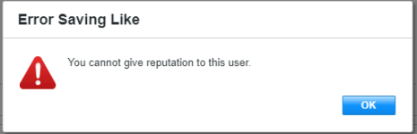

@Rob S.​ Every time I try to give a "Like" to your posts, a Banner comes up saying "You are not allowed to give this Member, blah..blah..blah.., a "Like'. I have not idea what's going on with that? Do you" :)
that is weird. I want to like you, Rob S., I really do. But the forum says I cannot.:dejection:
image.png​
