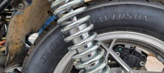

You have this. But it's just a regular Dunlop tire marketed for HD I would think. 20210621_131106.jpg
