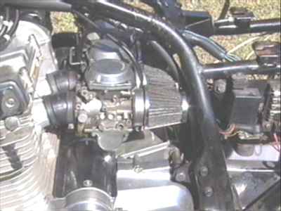

pic #1We took time out to revisit one of the old favourites. Suzuki GSX 1100. These bikes have a reputation for being extremely reliable and they responded well to engine tweaks for those speed freaks amongst us.

pic #2The example that we rode had a set of K&N's and a pipe on. The body work was still standard aside from a cut down seat. Paint work is understandingly not in pristine condition and the instrument panel is starting to show the effects of the harsh African sun after eighteen years.
