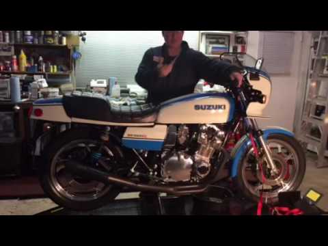

            My original petcock for my Cooley had a small crack in the diaphragm...so I replaced it with an old I had laying around here and ordered a new one. I had used a product called metal rescue on the rusty tank....lots of crap came out but still not perfect. I put in an inline fuel filter just in case.
            I took the tank off and realized the tank needed to be done again....
            The filter...
            I feel like I rushed the tank...dumb...being impatient to get on the bike. So this time I got some brushes and used nuts and bolts to shake around to get in the corners....I was going to use small rocks but decided on the nuts and bolts because I could put my magnet wand in the tank after to get them out...
            Yeah...not good...
            And the old pet cock
            So did the soaking all weekend and installed the petcock.....the metal rescue says there is no need to coat the tank if you are putting gas into it right away....just empty, swish around some gas...then fill her up! We will see....
            Got it back together tonight and fired it up.....man that Kerker sounds great! Imo...
