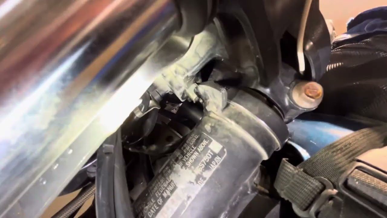

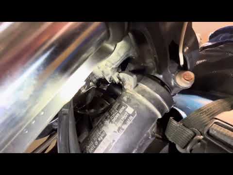

                          • 5558
                          Dave, here’s a short video of how the bolt moves and locks against a flap of metal on the steering head. Mine was a little sticky there so I did shoot it with first brake kleen, then some silicone spray. Definitely helped it not be sticky. Try as I might I could not put together any combination of swivels and extensions to get a tool on either of the recessed Allen-head screws that bolt the ignition barrel in place. Clearly I head the headlamp bucket out of the way the last time I did this. I believe the alllens are 6mm. Don’t quote me. Hope this helps.
