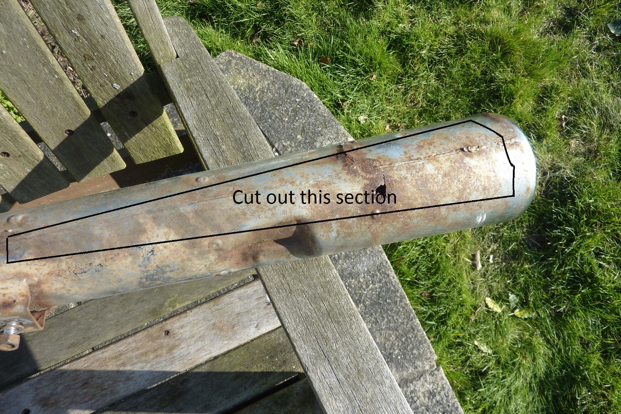

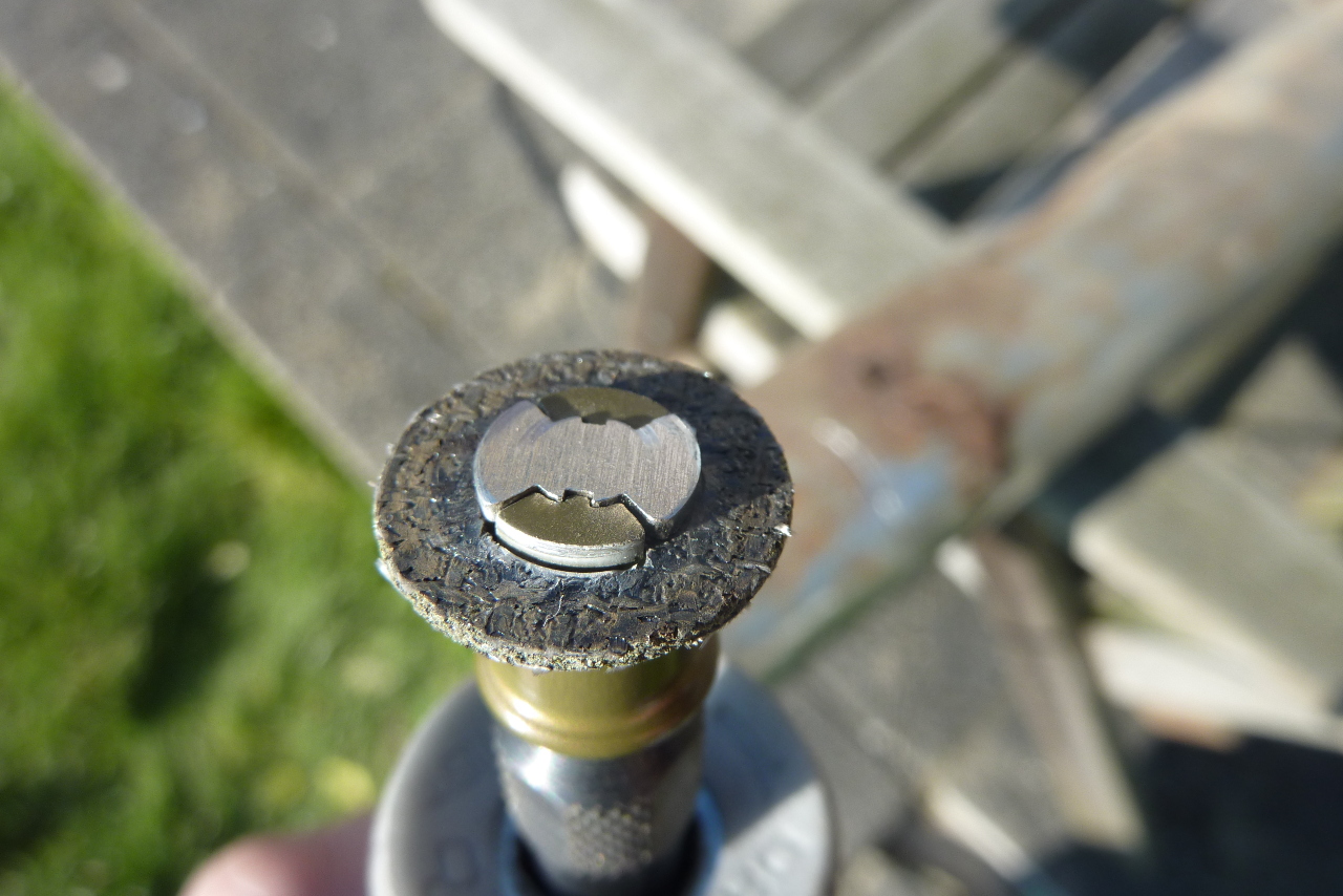

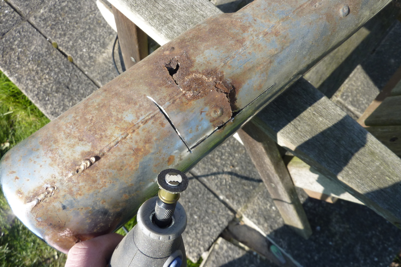

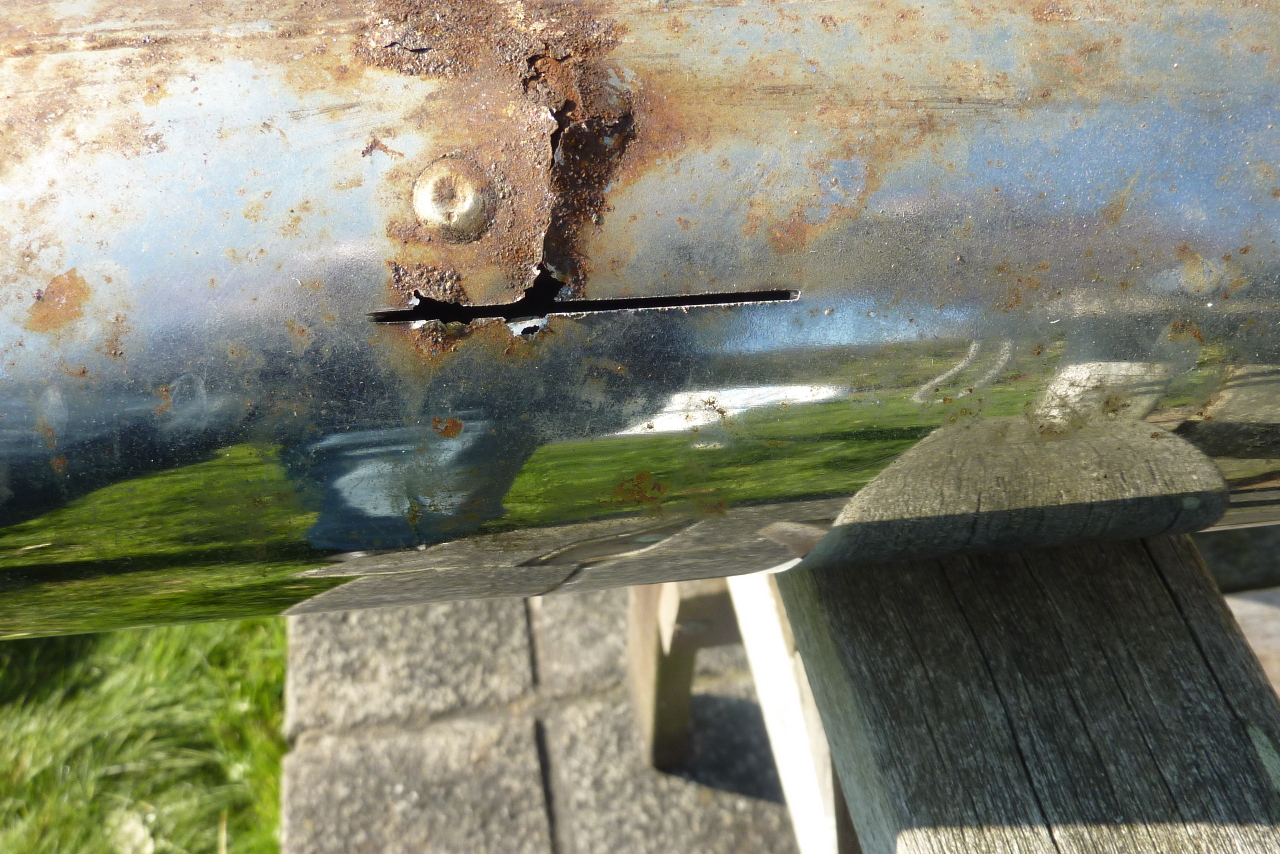

                        #176
                        Day 197 Exhaust Pipe Cut Up
                        We had a nice day here in the UK so I went into the garden to hack up one of my manky (rotten) pipes to see if there was any chance of fixing it.
                        See: My GS1100G Blog - Exhausting Pipes
                        This is what I wanted to do:
                        But I didn't really have the tools for the job.
                        I got the rattling thing out though:
                        Just wondering if I can cut the whole thing open, clean it up, sand blast it, have it brazed back together and then re-chromed. I estimate a cost of ?1,000 (or USD $1,600) for the pair. This rebuild is getting outta control.
