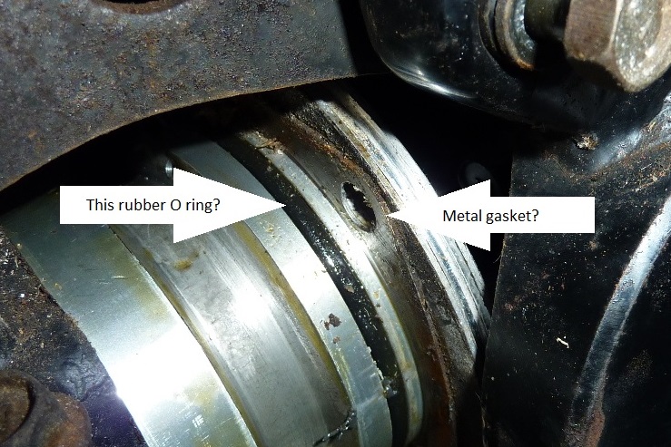

            You had the secondary gear out ! Don't forget to replace the big O ring before putting it back in the frame

              SqDancerLynn1 thanks for that. I might have been tempted to use the old one. There is also a metal gasket (type thingy). Do you think I will need to replace that. I don't know what it does.
              I am thinking that to get the engine casings polished up (and possibly painted) I am going to need to split the engine apart so ending up with 100% strip and rebuild. I have known this engine since the day it was purchased (1985) so I know there is nothing wrong down there. Am I opening a can of worms stripping it down unecessarily to the very casings? Or do you think I can restore the casings without splitting them?

                  That metal thingy is not a gasket but a spacer (or several of them of varying thickness). They are used on secondary gears to get the right level of engagement between the gears. Mine actually have too much slack in them so there's a "clunk" each time you accelerate after a deceleration. This situation adds to the wear on the gears as well. If the gears are too tight together that promotes again (expensive) premature wear.
                  I don't know what the specs are for the setup, perhaps someone else does?
                  But each engine has an individual setup as the tolerances are very small.

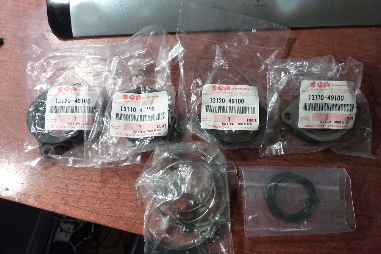

                      Day 124 New Parts Arrive Old Parts Come Off
                      Unless you are actually involved in a rebuild / restoration project like this, you will simply have no idea how exciting it can be to get a parcel of parts.
                      See my blog entry: My GS1100G Blog - New Parts Arrive
                      These new carb boots are simply beautiful. Just a bit of metal and rubber to some but not to me.
                      I have also been taking off a few more bits; the frame is nearly completely stripped now apart from the forks.

                        ....you will simply have no idea how exciting it can be to get a parcel of parts.
                        Just like Christmas every time a parcel arrives. I know, believe me I know. Those that aren't into it, look at you like you've got three heads getting all worked up over bike bits. I pity them.
