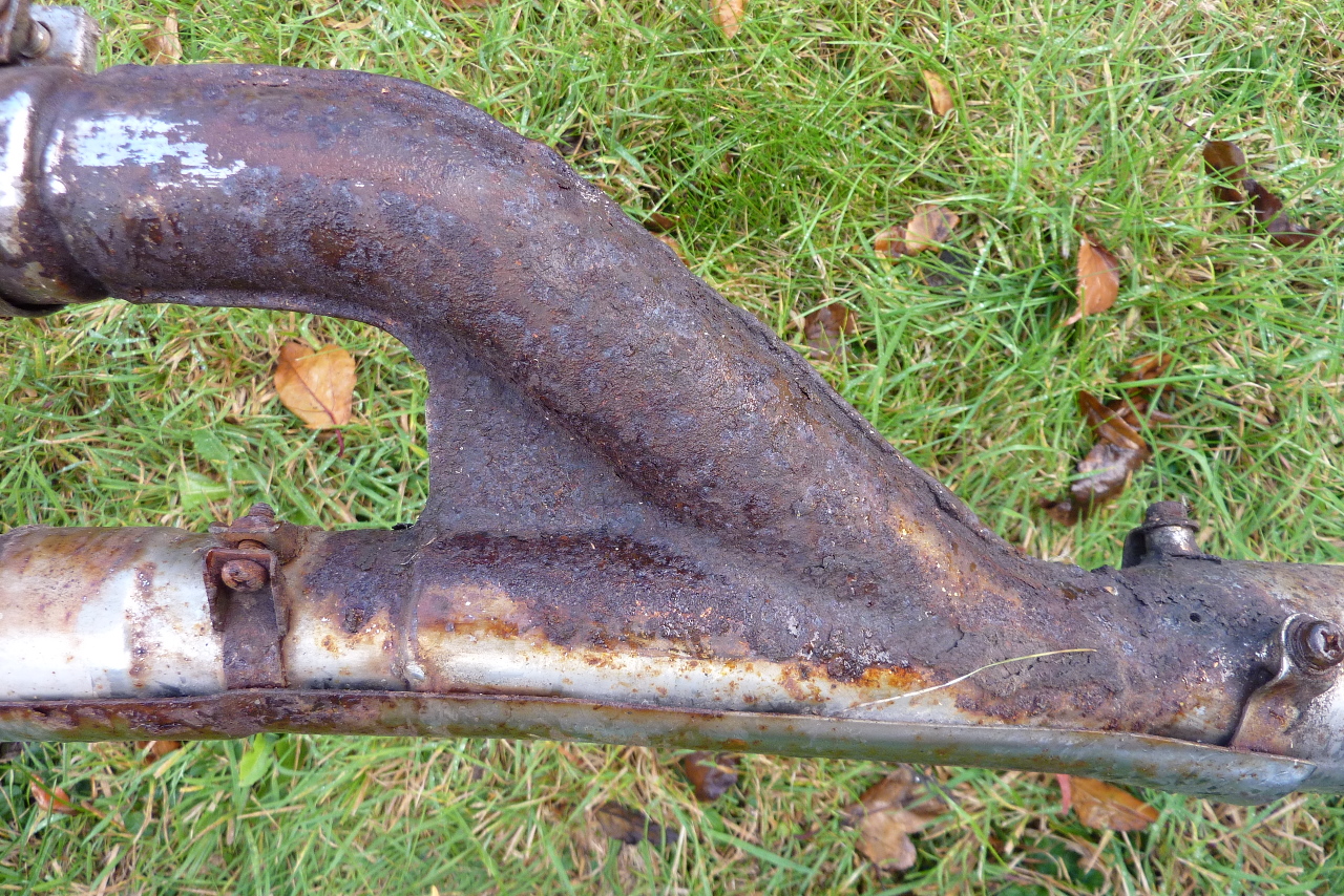

    Day 57 Exhaust Mufflers and Headers Off

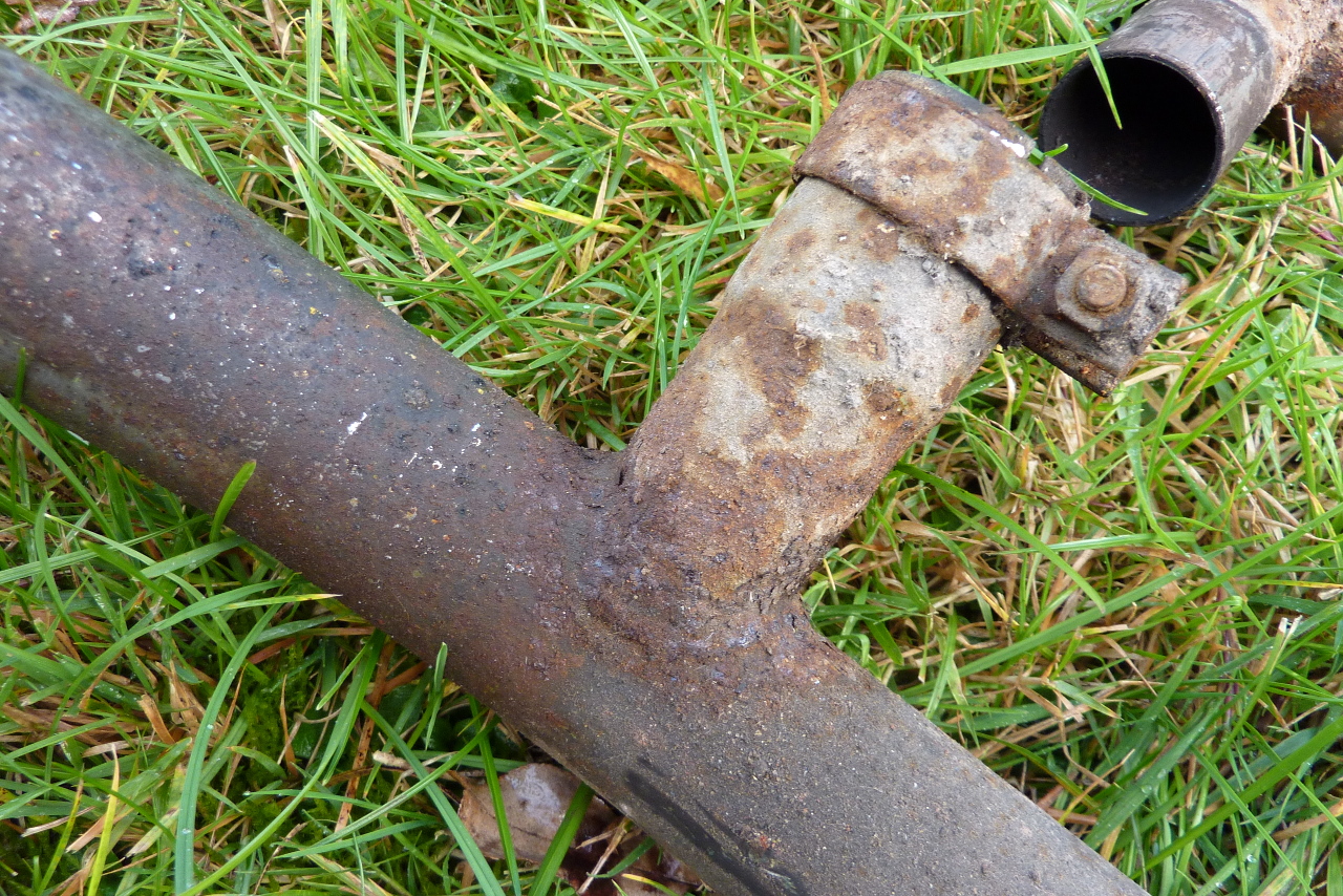

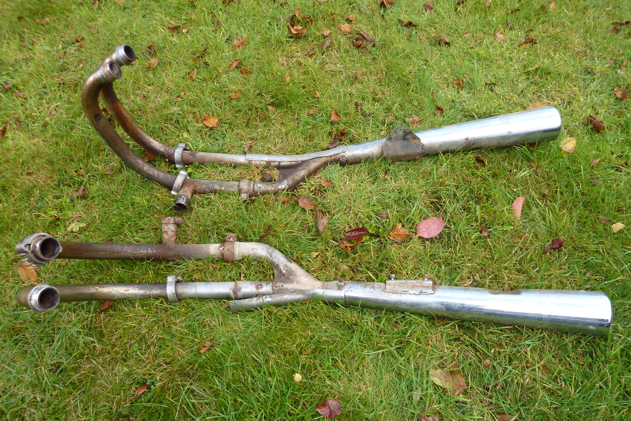

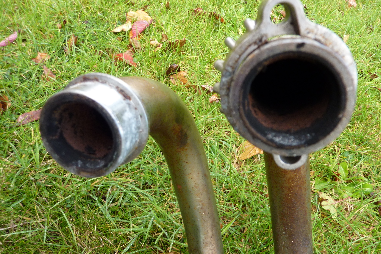

    So with the exhaust bolts firmly behind me I now get to take off the complete exhaust system. Oh my what a mess. They are in quite poor shape. Lots of rust powder poured out from the header pipes and both mufflers have rattling baffles and holes in their skins.
    Can these be refurbished? I know replacements are not available. So what next?
    Here's the blog entry: http://suzukigs1100.blogspot.co.uk/2...ed-day-57.html
    Not sure I can even salvage the headers as they are welded on to the mufflers.

      They look too far gone to me. If you want original you'll have to look to the US (I bet you'll never find one in the UK). Here's one:
      Find many great new & used options and get the best deals for 83 SUZUKI GS1100 GS 1100 GS1100G EXHAUST, MUFFLERS #E2 at the best online prices at eBay UK! Free delivery for many products!
      Failing that it'll be a Motad or similar, 4-1 for about £350.

        Hampshire - actually it's not THAT expensive. I will set up an Ebay search alert I think. I was really hoping someone might be able to cut them open, derust, repair baffles and then put back together. But that would probably cost more than the US set. Then there is the re-chroming. Initial enquiries show this would be in the region of £500 plus. But the US ones needed re-chroming too. This is getting very costly.

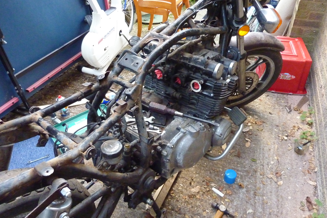

          Day 57 Progress
          Exhausts are off, foot pegs, mirrors, clutch cable and more.
          See blog entries: Day 57 Progress

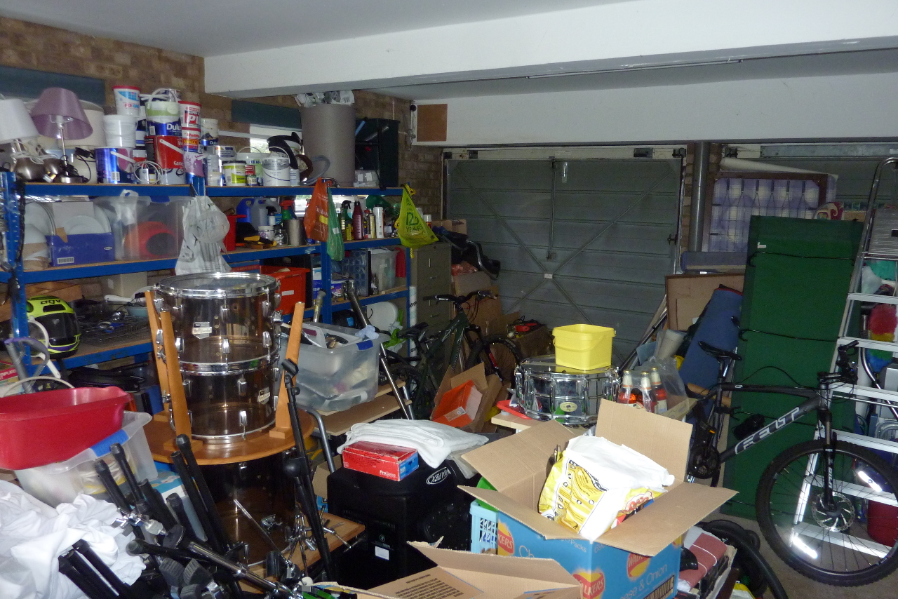

            Workspace

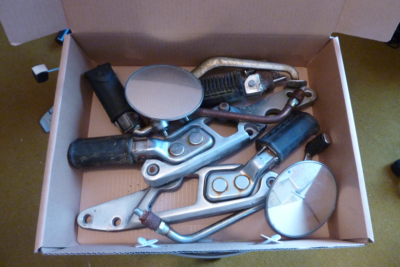

            I need to do something to make some space in the garage. I have to bring the project inside now for the winter. Any ideas?
            I am boxing up all the part and putting them away for now.

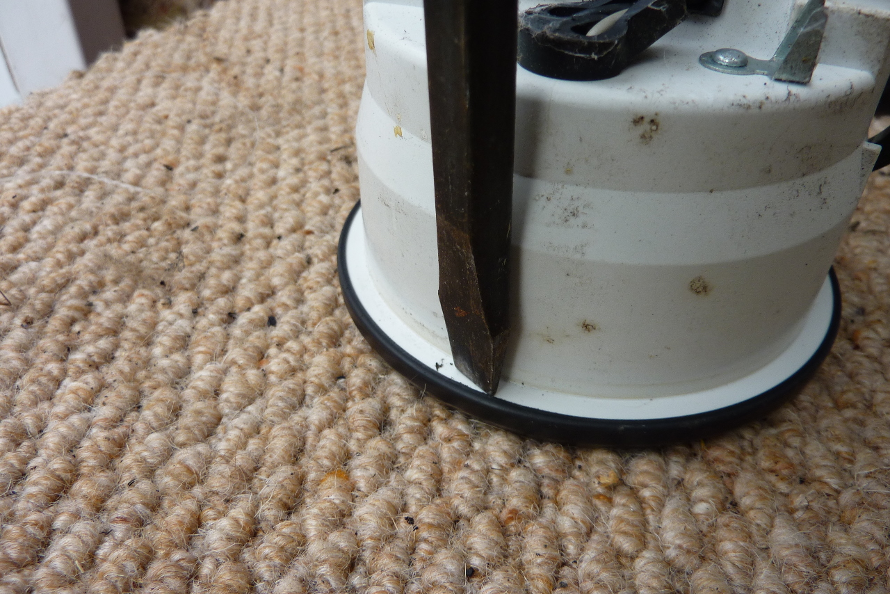

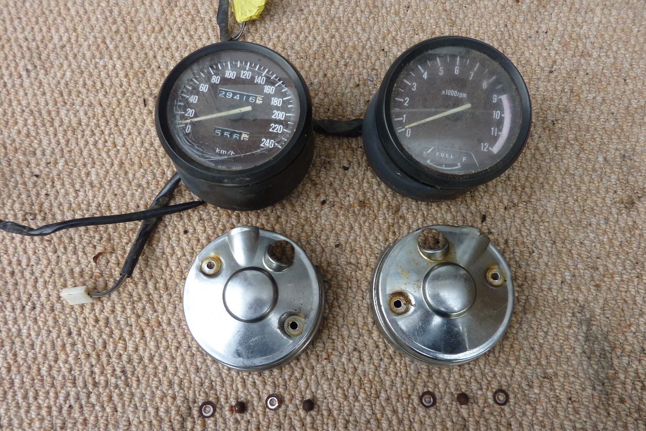

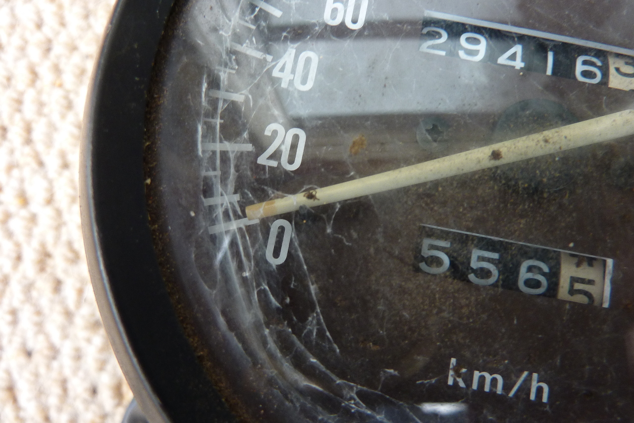

              Day 59 Instrument Removal

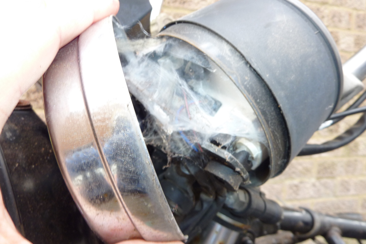

              Took the instruments off at last. Something was living inside my speedo and it has deposited stuff all over, including I believe on the glass. So this leads me to think I will not need to replace the glass (thanks Hampshire). I still have to get the glass off by removing the retaining band, so I will be able to check it then. But the glass has to come off in any case as I have to change the facias (which will be supplied by: will.barber@bentley.co.uk). I need to have one to show MPH which means I need to change them both. Oh the joy, I have to remove both glasses!
              See the daily blog entry: GS1100 Blog
              Anyone get any other tricks to remove the glass?

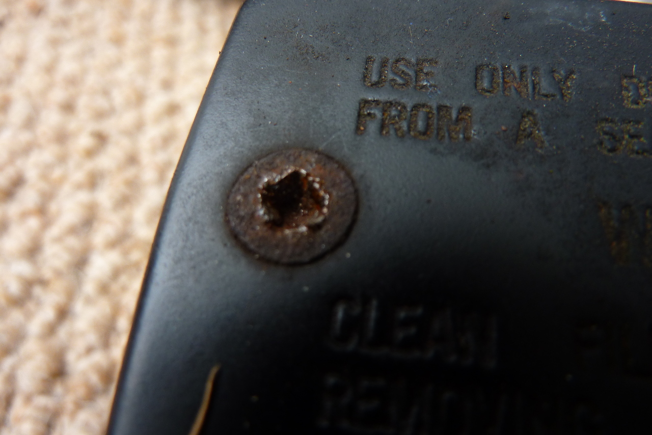

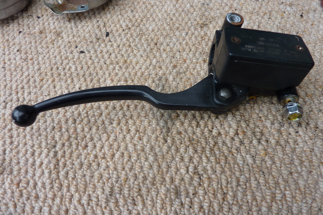

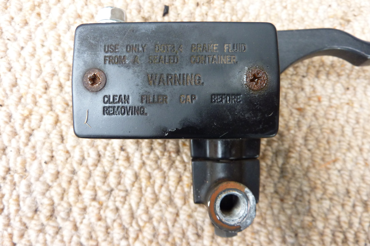

                      Day 60 Front Brake Reservoir Problem - Screw Stripped
                      I was doing so well getting the exhaust bolts out without a problem now I have my first stripped screw. To make matters worse it is a flush sitting screw so I can't hacksaw a groove into it.
                      Any ideas?

                        A sharp easy out will help.
                        Get the right drill bit for the easy out and just drill in enough to make it bite then try to unscrew.
                        In that thread size you may not get one small enough so see what they have.
                        Another option is a reverse bit, it loosens the screw as you drill and may knock it loose.

                          Bevo - You will have to educate us poor people on the wrong side of the Atlantic as to what is a: Sharp Easy Out.
                          I don't know what it is.

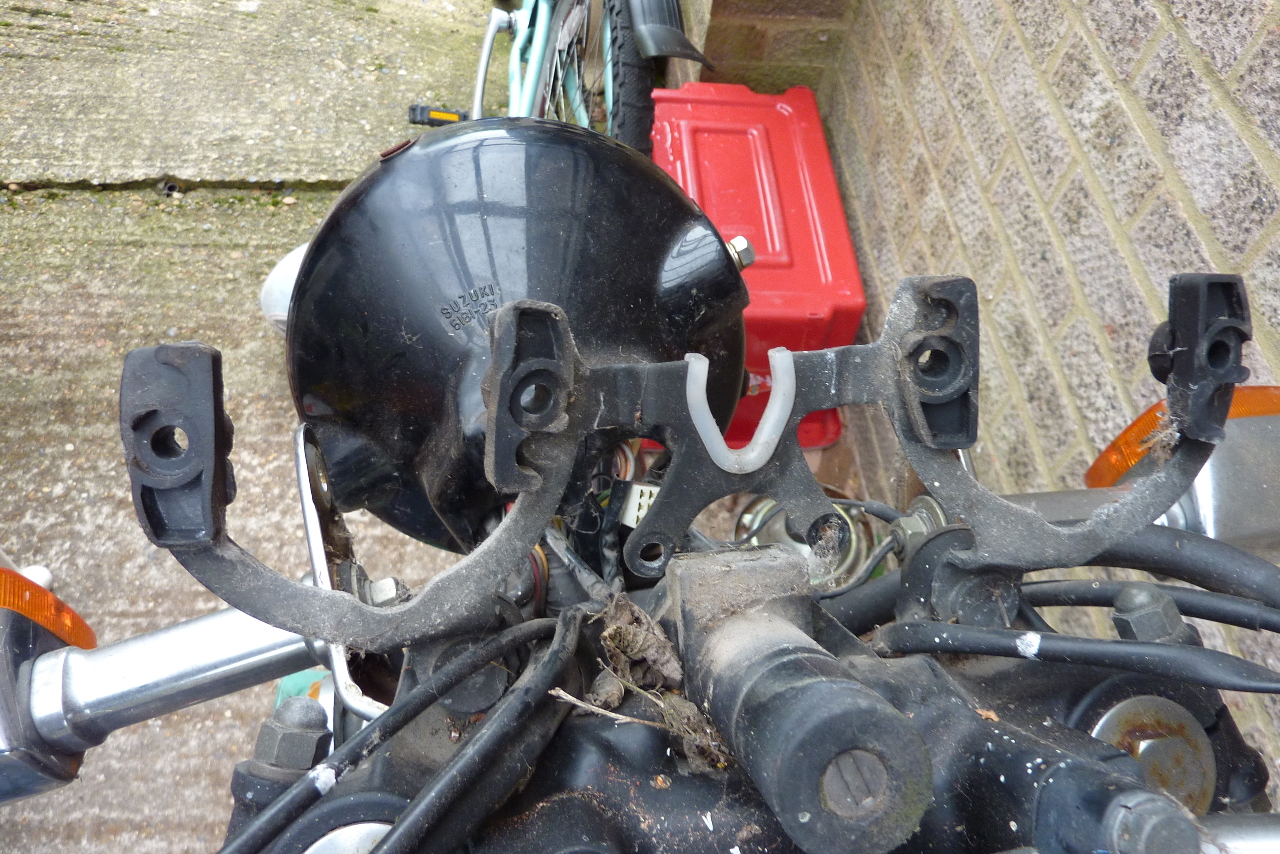

                            Day 63 Progress Report
                            I am keeping up the momentum on this project - fear not. Today I continued to remove the headlamp shell, the handlebar switchgear, the instruments, wiring routing and other such stuff.
                            Check out the blog here: GS11200 Blog

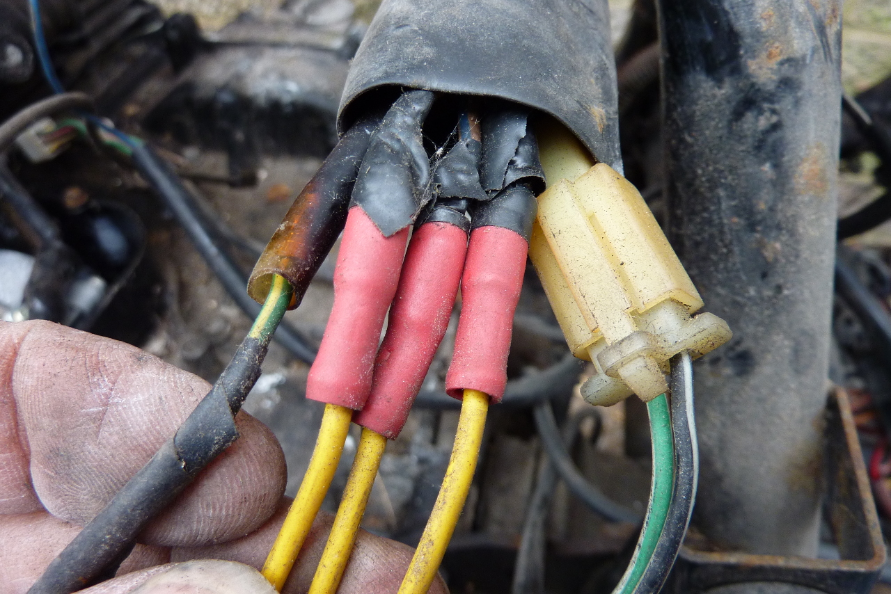

                            This last pic looks like someone has really gone to town on the stator wire connections. Does this taping and soldering (I can't pull them apart - so I will have to snip them) look OEM?

                              That'll be a replacement non OE reg/rec. They have three yellow wires, a red and a black.
                              Here are the connections FYI:
                              Red-Red
                              Black-Chassis/ground
                              Yellow-Yellow
                              Yellow-White with blue tracer
                              Yellow-white with red tracer
                              The green + yellow wire on the left is the feed from the start button to the solenoid.
                              Not sure what the other two are with the white connector block but I don't think they're related to the charge system

                                This Forum is truly amazing. Just can't imagine there is a guy somewhere on the planet who has experienced the exact same issue that I have on a piece of equipment that is 29 years old. Brilliant. And thanks for that post. Really appreciate it.
