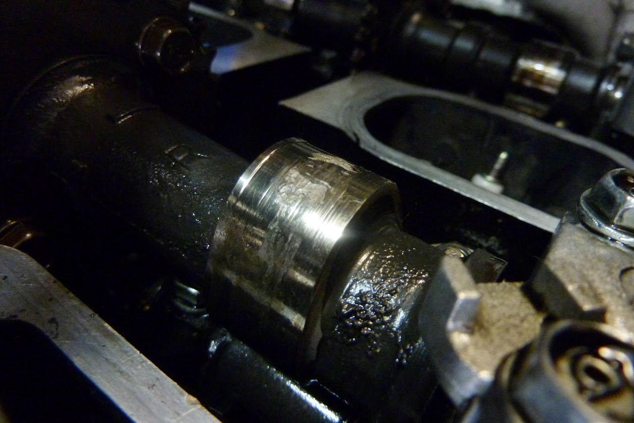

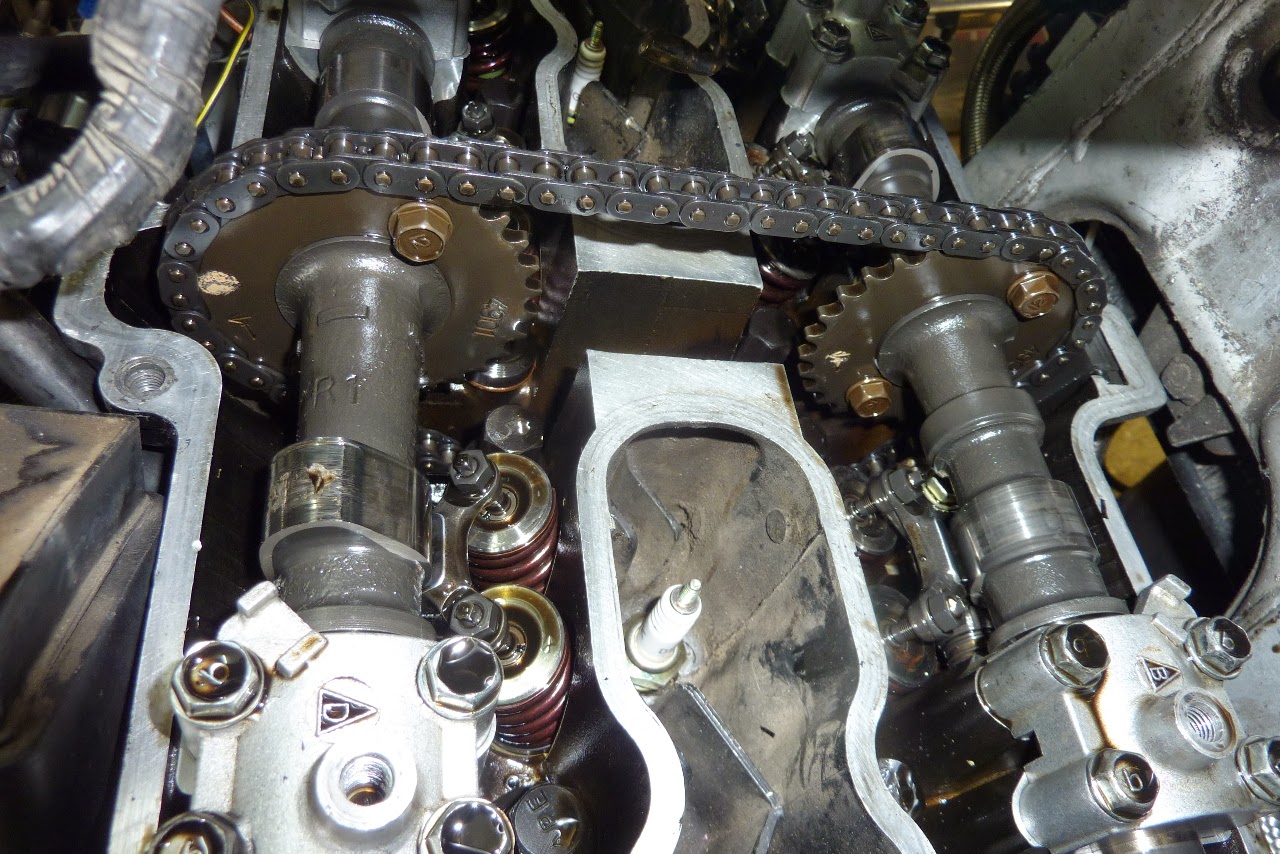

Now it seems the carbs are working, I figured I would have a look at tappets and see how the cam chain was looking with my manual cam chain adjuster. I was horrified by my cams:
When I prodded the lip on this lobe, it came off:
And this one was gouged out badly:
Was this oil starvation? It was only on the right hand side of the engine that the lobes were damaged.
What does this say about the rest of the motor?
Very disappointed with this now.

Sucks man. My condolences to your wallet.Ed
