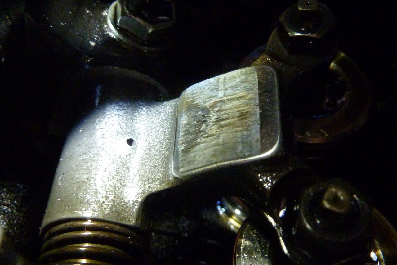

                          Exhaust Cam Condition
                          This is what the exhaust cam and bearings look like:
                          And the followers have some scoring:
                          This motor has been breathed on at some stage; Ape parts and high lift cams:

                            #103
                            Nasty ...

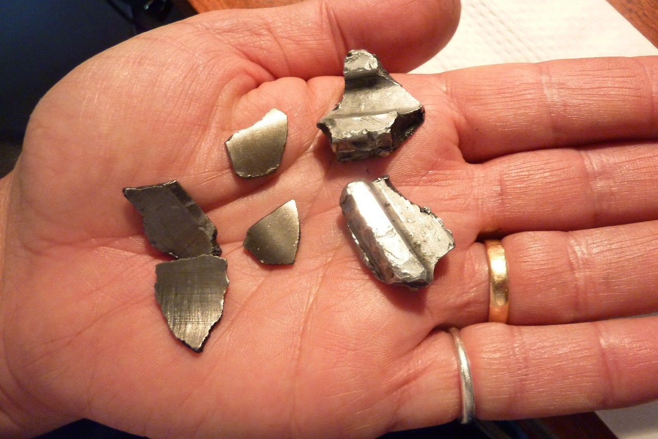

                              #104
                              Serious Metal Chunks Found in Sump
                              With the damage I have already seen to the top end of this motor, it was suggested that I remove the sump / oil pan and see what what is there. Shocking. But with a caveat. I have checked the clutch and pistons and they are all peachy (good). In fact the pistons are hardly scored at all.
                              I am thinking (praying) that this might be the residue of a previous engine failure. OR where else could these chunks have come from? We are talking serious bits of metal here:
                              (for the whole picture set see my blog here: GS1150 Metal Chunks)
                              The bigger pieces (aluminium):
                              Smaller pieces are steel:
                              All of the smaller pieces have this grooving on them:
                              Clutch and pistons are good:
                              Help!!!

                                #105
                                some of those steel bits look like the bottom of your liners.
