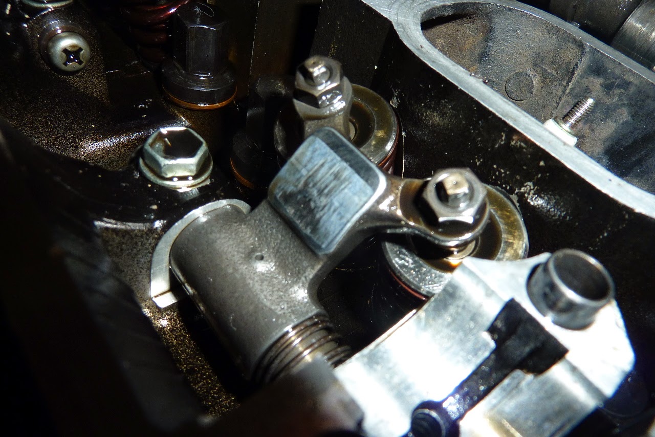

          More pictures now the cams are out:
          Greetings
          Richard

                The journal is stuffed, is the head goosed too?
                  • 5802
                  #83
                  Ouch. Ah, the tender ministrations of some PO and his cheap-ass maintenance regime.

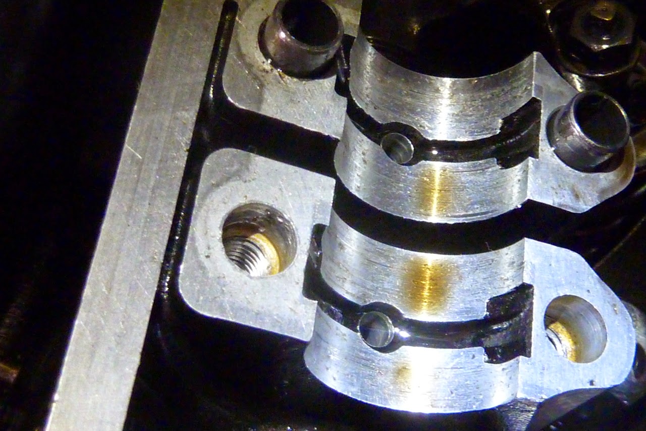

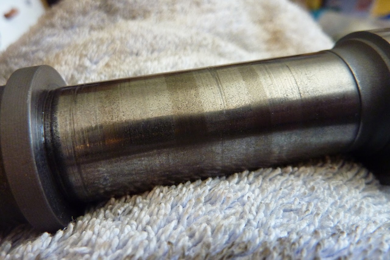

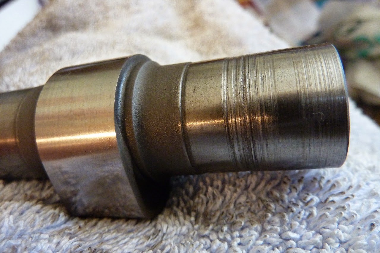

                    Journal Bearings and Cam Followers
                    Here are some pics of the journal bearings and cam followers
                    This journal:
                    came from these bearing holders which look OK:
                    And this journal:
                    came from here:
                    And these are the cam followers:
                    How do you fix goosed journal bearings and cam followers?

                      Unless you are a machinist you don't... Do you have a good machine shop around you? If I were you I would take the head to the shop for them to evaluate.
                      You could look around on ebay... but being in the UK not sure how available those kind of parts are...

                        Well it looks like the cam journal bearing holders on the far left and right (middle pairs look OK) of the head are pretty scored up. Not sure what you can do about that as they are integral to the head. I'm thinking of taking the head off now (I also snapped a cam journal bearing top cover bolt) to see if anything can be done with it.
                        I don't want to spend money on this bike. I need all the funds to go into the GS1100G Resto.
                        So - what to do?

                              Some of the Hondas that had cam oil feed issues were reclaimed but it was only because they were still fairly new bikes and worth a few quid still. The work involved building up the cam journals and grinding to size again, and machining a recess in the head and caps to take a shell bearing. Costly work and is it worth it to pay a machine shop? If you had your own kit to do it cheaply, and if it were a rare engine, it's not a scrap head.
