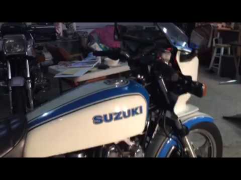

    Thank you to Mark and Rob for helping me with this project. I appreciate your friendship and talent to restore a classic motorcycle...I clearly could not have done it without you two!! Cheers

      Looks great, Trevor.
      I don't know enough about the S. Is the black trim on the windscreen stock?
      I have a Zero Gravity and Gustafson and neither have the trim. The stock one i have is slightly "out of round" like the one on yours.

          Lookin' Good Trevor!
          That seat looks just like the "L" seat I have on my "T". Is the original supposed to be flat...like the "T" seat? Just curious...
          Overall, you and your buddies have done a great job!

            Yes the black trim on the rim of the windscreen is stock. You can get rubber edge guard from marine supply stores thats "close". Google search for windshield trim got this..........

                    Why is the oil light flickering??????
                      #100
                      The bike isn't used to the Canadian oil yet...
                              Usually means low oil pressure.

                                Sort of. These roller bearing cranks only use about 2 - 3 lbs oil pressure at best so it makes the oil pressure switch finicky and prone to that type of flickering if it's not 100% especially when you add an oil cooler take off right at the switch. Usually nothing to worry about.
