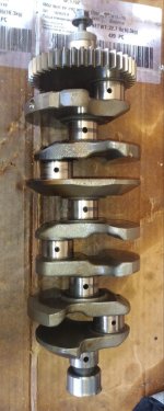

Thank you. My problem originated when I installed the cam chain tensioner incorrectly, not realizing they do not retract under spring load, so it was waaaaay too tight. It ended up causing the cam chain to grind away at the intake side chain guide leaving ground up black plastic all over everywhere around the top of the chain opening at the top of the head. I cleaned it all out, then took off the oil pan and found it all in there too, as well as clogged up the pickup screen. I cleaned it all out there too, but I suspect it got into the oil ports supplying the rod bearings and blocked that one out. I did find several crank shafts for sale on ebay in case I need to get another. I'm currently waiting a some tools to be able to remove the alternator rotor so I can split the crankcase and get to it.
That thing really got hot. Before pulling the cap off, I could grab it and rattle it back and forth, hense my mysterious engine rattle. One half of the bearing was rotated halfway overlapping the other half.

What's the plan? New rod & main bearings? Might want to fully disassemble and blow compressed air through the oil passages to make sure there's no residual metal/plastic bits hiding out in there. Also maybe disassemble and clean the oil pump to ensure no detritus is lurking there as well.
Gonna need at least one new/used rod too.
