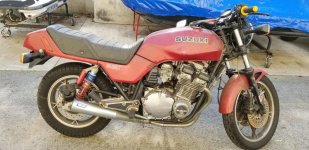

new member here. This belonged to a life long friend and has been sitting under a tarp for 30+ years. We decided it needed to be revived. I have been in the industry for 35 years and it feels good to put together a long lost "family" member

Looks like it survived fairly well, but I suspect you will find many things to attend to.
Is a well saught out model, in stock config (except bars & exhaust), well worth the effort.

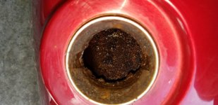

20180525_094752.jpgtank after cleaning with hot water, power wash,an overnight visit with a mixture of hot water and Metal Restore and another final power wash. used Caswells tank liner. good to go.
My roommate from long ago bought this new . he rode it until the hot new (Ninja 900) came along (1984?) and he had to have one. He sold this to another of our friends who has had it since. Life got in the way, weddings , families careers etc and we hadnt seen each other for 25 years.We reconnected as though time never happened. He has MS and is unable to ride and I thought he would like to see it running and being used again so I am doing this. I have been in the motorcycle business for my career and enjoy side projects like this.
I have it running, next project is rebuild of the Fox shox. they all have an issue with the original bottoming bumpers dry rotting and disintegrating. I have all the needed parts to rebuild so that is next and doing a 530 chain conversion at the same time. I will post more of it as it continues its slow process.
