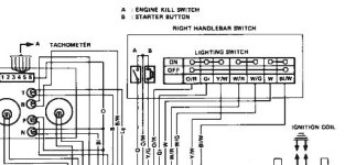

I?m redoing the entire harness as it is a corroded mess. All in all it?s pretty straight forward, and actually an enjoyable learning process. I?m also changing out the handlebar controls which are coming from other models.
But! I have hit a wall with the Lighting ON/OFF and headlight dimmer switches. What makes is more confusing is that different wire diagrams show different things. Some don?t even show the lighting switch?
Currently (old to be switched out) what I have on my right handlebar controls is a lighting switch which has three positions:
  • OFF
  • what looks to be PARK (S)
  • ON
The left one has a LOW / HI dimmer switch integrated into the LEFT / RIGHT indicator control.
So far so good!
The issue:
My understanding is that the right control turns the lights ON / OFF, and the left once decides whether to use LOW or HIGH. And please correctly if I?m wrong, but that requires +current to be sent from the right switch to the left handlebar control, which then switches between LOW (white wire) / HIGH (yellow wire) into the headlight. That connection however, seems to be missing on most wire diagrams I have found. The best I can find is the one I?m attaching here, where there is a thin line between the two switches.
The Questions:
1. What is this thin line between the two switches, is that a wire, which color?
2. What is the middle position on the lighting switch (marked S on mine). It?s not showing on any diagrams I have seen.

Concerning a GS450 from 84-ish
I’m redoing the entire harness as it is a corroded mess. All in all it’s pretty straight forward, and actually an enjoyable learning process. I’m also changing out the handlebar controls which are coming from other models.
But! I have hit a wall with the Lighting ON/OFF and headlight dimmer switches. What makes is more confusing is that different wire diagrams show different things. Some don’t even show the lighting switch?
  • OFF
  • ON
So far so good!
The issue:
My understanding is that the right control turns the lights ON / OFF, and the left once decides whether to use LOW or HIGH. And please correctly if I’m wrong, but that requires +current to be sent from the right switch to the left handlebar control, which then switches between LOW (white wire) / HIGH (yellow wire) into the headlight. That connection however, seems to be missing on most wire diagrams I have found. The best I can find is the one I’m attaching here, where there is a thin line between the two switches.
The Questions:
2. What is the middle position on the lighting switch (marked S on mine). It’s not showing on any diagrams I have seen.
P.S. I’m also eliminating the stator loop.
As per the schematic the lighting switch has two position OFF and ON.
The diagram you point out is of the switch. It makes a connection where there is a short "wire" (line), in the indicated mode (either ON or OFF)
A few things going on here that are out of our (the US market) normal. :-k
1. None of our bikes had a light switch on the right side.
2. Our bikes that did have a switch (up through '79, maybe a few through '80) had the switch on the LEFT side.
3. The combination up/down and left/right switch was rather common.
4. If you still have a stock Regulator/Rectifier (R/R), keep the 'stator loop'. If you have upgraded to a series-type R/R, you can eliminate the loop.
The thin line between the two switches appears on the diagram for my '80 850. It is actually a yellow/white wire. It starts at a connector where the stator loop happens. There is an orange/red wire that comes from the fuse, then loops back to a gray wire that feeds the instrument cluster. Along with that loop is the yellow/white wire that goes to the headlight selector switch.
If you do actually have a stator 'loop', you should not have a functioning headlight switch. However, things were a bit different in the European market. When we got the federal mandate to have the headlights ON all the time, the rest of the world was still allowed to choose. Rather than change the entire wiring harness, Suzuki chose to only change the sub-harness that went to the left hand grip switches. The headlight switch actually controlled two circuits at the same time. One was for the power to the headlight, the other interrupted one leg of the stator, which reduced the overall stator output and prevented the R/R from working so hard.
I believe that your right-side switch might be from a Honda or Kawasaki.

Thanks Steve,
Yes, this must be a European model where we are also driving with the lights on at all times, so I don't really need the switch.
So in reality I could just feed the dimmer switch directly from the orange wire, or is there another way of doing it?
I do have the stator loop in the old harness, so I guess the lighting switch never worked anyways?
I have a new R/R so should be OK to eliminate the stator loop as I understand it.

Hi All,
Here's an update.
After doing a lot of searching in different schematics, I figured it out. In Europe we have the lighting switch on the right hand, which sends + to the left hand dimmer switch. From here there are two options into the head lamp, HI or LO. Nothing hocus pocus about that!
Another thing I learned: you can pretty much do your wiring as you like on older / more simple bikes (well with some rules that don't allow to be bent), and since I'm redoing the entire harness, then I decided to do it the way I want it.
