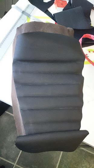

                    #144
                    I have started the seat, this might prove to be the most challenging task of them all!
                    A layer of foam to cover up any irregularites...
                    pattern for the sides of the seat
                    Seat innlay
                    • Spiff
                      • 318
                      • Norway
                      #145
                      I have made a seat

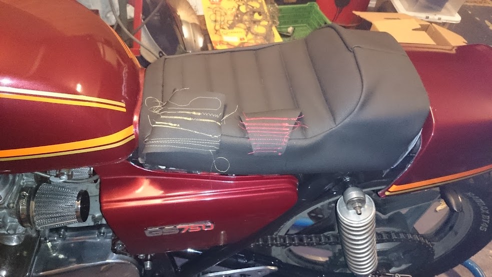

                          #147
                          Thanks, now I just need a staplegun so I can stretch and fit the seat cover... I thougth about using spray glue but then I would never get it off again if I ever want to redo it or something...
                          I was thinking of adding a some contrast stitching in either gold or red but now I'm not so sure... What do you guys think?
                          • GateKeeper
                            #148
                            do the red if your going to do it...
                            • Charlie G
                              • Feb 2009
                              • 6440
                              • Siskiyou county
                              #149
                              I don't think I would.
                              cg
                              83 GS1100g
                              2006 Triumph Sprint ST 1050
                              • Spiff
                                • 318
                                • Norway
                                #150
                                I think I'm just gonna leave it as is.
