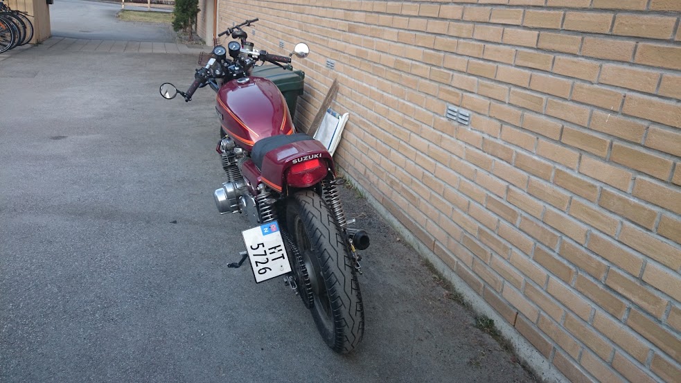

        Finished? Mostly, yes.... I need to get a new brake light switch up front, the current one is broken which is kinda bad since the front brake is what I use the most :P
        I also need to take apart the light switch and clean it since there are some small contact issues from time to time.
        But it's driveable, at least thats something right?
        I also ordered a smaller license plate today.

            #155
            Nicely done! I think I'd move the tail light back a bit to be at least flush with the end of the rear cowl. Seat turned out good. Like your pink ride with training wheels
