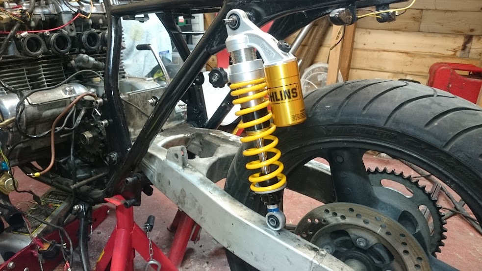

          So I sort of changed my mind when I came to this build and decided to toss all the gsx-r parts in favour of sv1000 and bandit parts. So for those of you who where hoping on a monoshock gs, sorry 'bout that....
          The new plan consists of a sv1000s front end, a bandit 1200 rear swinger with ?hlins rear shocks and maybe new paint... Frame bracing of course...
          So here's the donor bandit I got dirt cheap, removed the parts I needed and then sold again for the same amount I paid for it whole
          The bandit rear end and the stock shocks.
          Got some sweet looking gold! From a gsx1400:
          Turned out they had a 14mm eye on top, so I need to get a sleeve made since the stock ones are 12...
          The SV front end is dismantled but not mounted on the gs due to freezing weather(I have the same temp inside my garage as outside :P)
          But the SV is located in a heated storage facility so it also got the gold treatment...
          Plenty of stuff to keep me busy!

              Trying to muster up some motivation to get this going again. Digging up this thread is step 1. Getting some clevis mounts to weld on the swingarm so I can attach the rear shocks is step 2.
              Then maybe I'll strip it down again so I can start to brace the frame...

                #172
                That's a fat tire! Reminds me of my gixxer.
                These vintage bikes don't make the same horse power as the fuel injected Suzuki's of the early 2,000's. (Of course, I could be challenged by the statement)
                Bike looks good except that rear seat catches the eye; for better or worse. To me it looks like it's missing something but, "hey!" It's your bike.
                Keep up the good work no matter what we think here. In the end, hard work and dedication is a labor of love.

                  #173
                  Yeah it's a 180tire so same as most gixxers although I think newer ones use a 190(at least the 1000).
                  I might have to go with a 160 or 170 depending on the clearance of the chain.
                  My grand plan is sourcing a gs1000 engine and boring it out to about 1200cc with high compression pistons and a bit more aggressive cams. Wanna put the racer back into caferacer as I think it's now more about style and looks than performance for many.
                  But chain driven 1000's are rare here so in the mean time I'm gonna concentrate about chassis and getting it rideable again... Been almost two years since now...

                    #174
                    You'll probably find that the 180 tire is too wide for the chassis - the chain will be sawing into left frame tube
                    But, check the chain offset and see what you've got

                      #175
                      I don't think it will rub on the frame with a 520 chain, I think I've seen another here do that. It was close but it worked. Even with a narrower tire the rear sprocket is still in the same place, so would need a negative offset rear sprocket in order to get the chain further from the frame

                        #176
                        Or machine down the rear sprocket carrier, that's what I did with mine.
