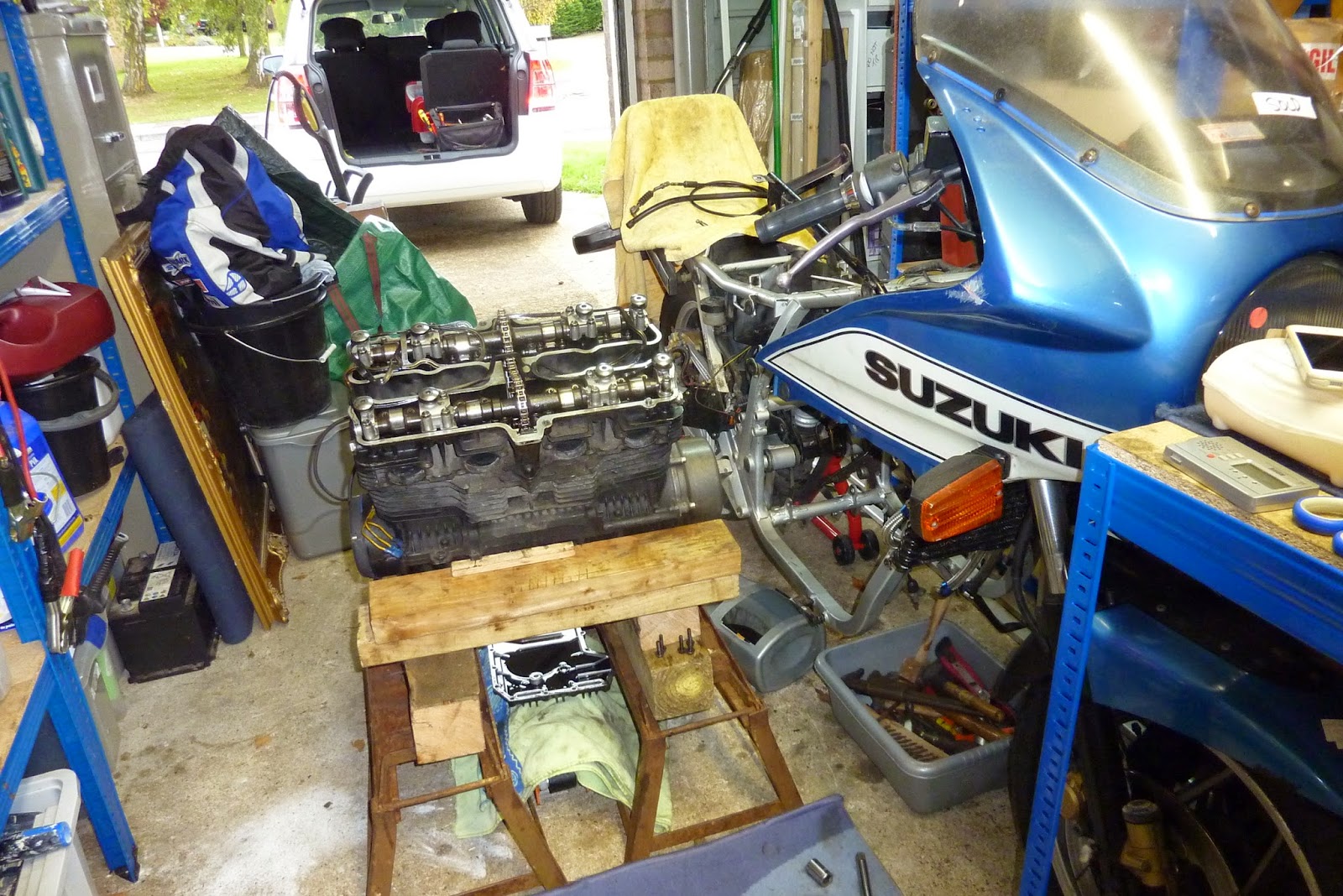

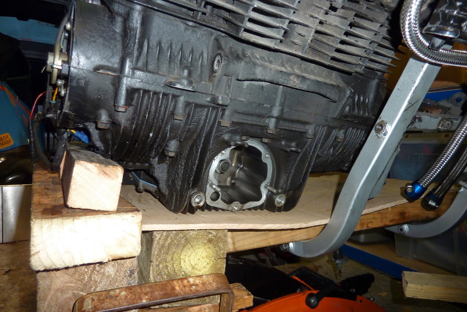

            "New" Engine Install
            So I'm getting the new engine put in now.
            See my GS1150 ES Blog - Engine Install (hi-res pics there).
            Then I got a couple of helpers to raise the motor a little and pulled the platform out and rested the motor back on a car jack so I could line up the bolts.

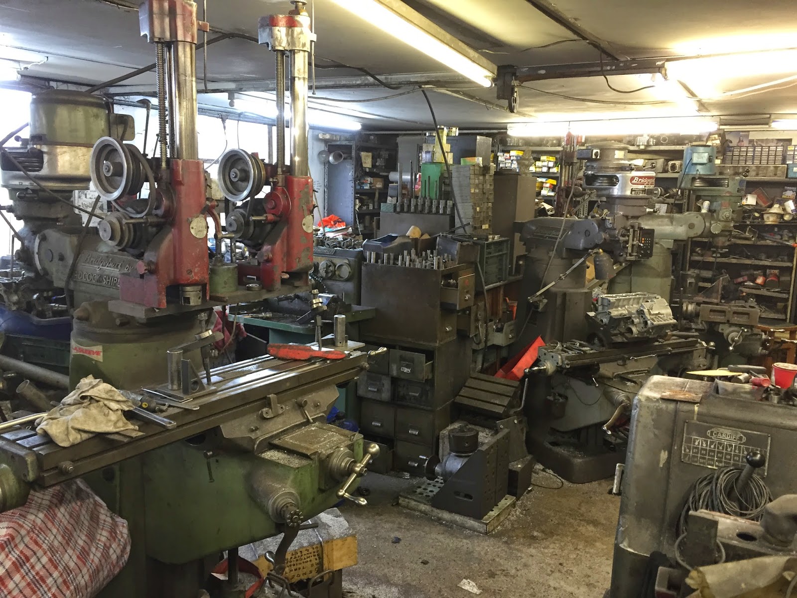

                      In the meantime, I took the old engine apart completely, ditched the head and sent the crank shaft away to be fixed. I found a local guy (only 60 miles from me) who has been reconditioning cranks (and particularly GS1150 / GSX1100 cranks) for the last 30 years. This is his workshop:

                          I love the old school "unsanitized" shop with parts, etc floating around....I could only imagine that there's some good stories there after 30 years. Richard, you are one busy fellow. I hope the 1150 project finally turns up some good luck. Sound like with the lengths you're going its an inevitably.

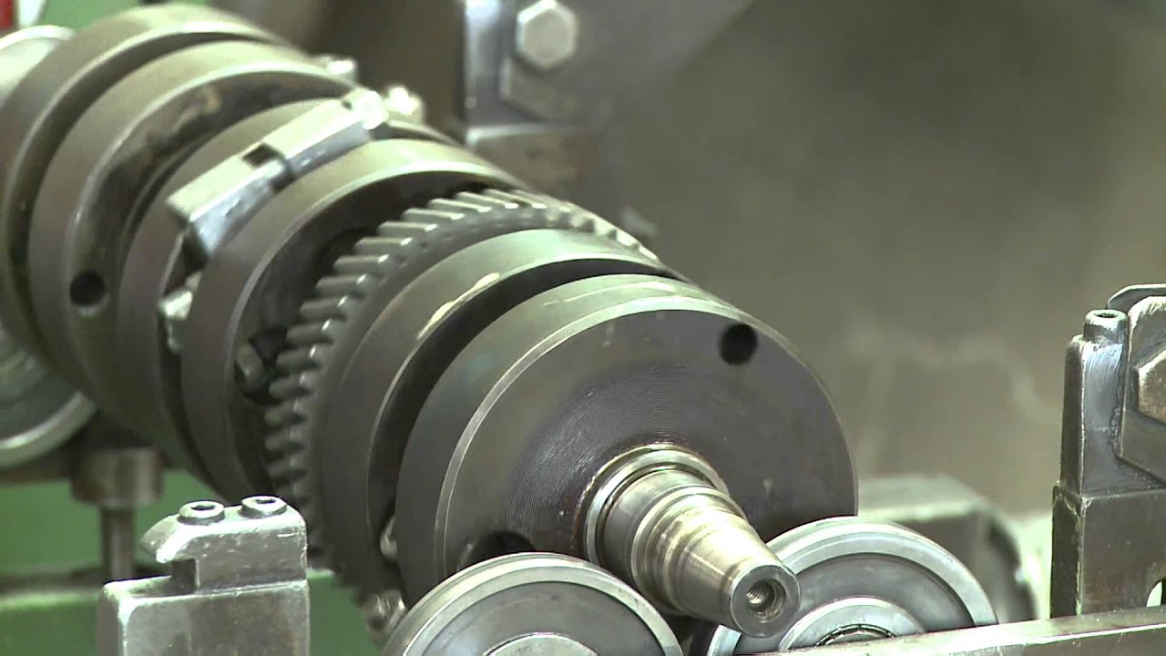

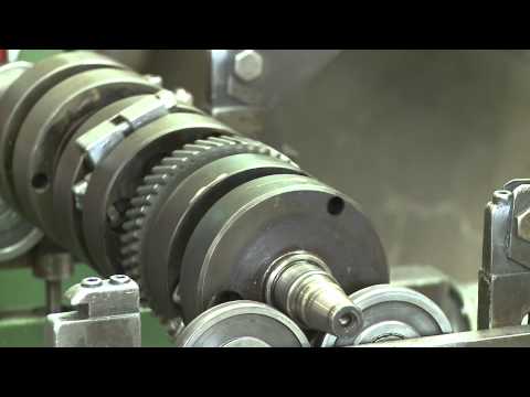

                            I wanted to ask the guy if he would spend a day with me and tell me some stories. I wanted to pick up every engine piece and ask it's history and how it came to be in his shop (and obviously some of them abandoned in his shop too). Really interesting guy (just like some of the guys on this Forum who could tell some great drag racing stories) - he also was into hydroplanes with 2 stroke engines. This was him in the 1980s:

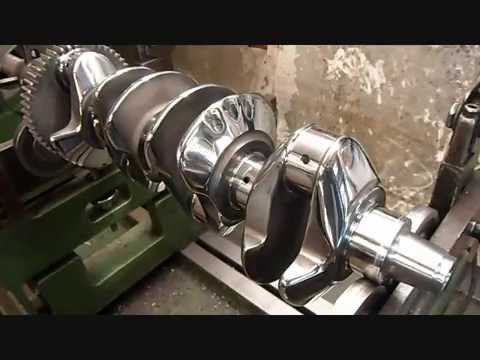

                            This is some Busa crank work he has done:
                            and if you ever wanted to know how a crank was balanced. Here is a GT750 crank being done:

                              #149
                              Wow, I didn't know polished cranks where a thing.
                              Charles
                              1979 Suzuki GS850G
                              • ShadowFocus603
                                #150
                                I believe the idea behind them is that a polished crank is less likely to hold onto oil film as it spins thereby minimizing parasitic losses. Considering that was a Busa crank and the power levels those crazy b*stards go for I can't imagine it'd amount to more than 1-2 hp but I guess in some circles that's everything.
