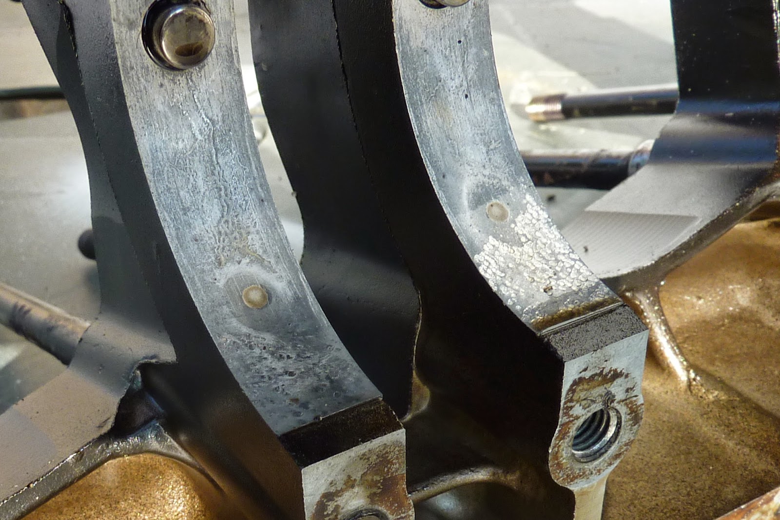

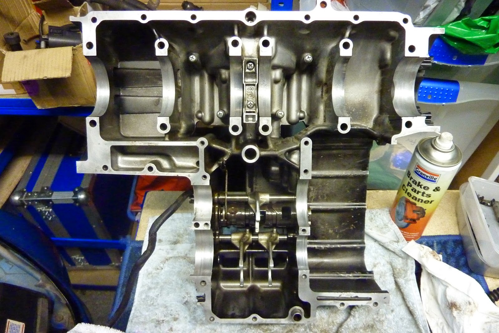

              I am putting in my "new" engine and at the same time working on the old "messed up" engine that I took out and stripped.
              I sent the crank away to a crank man:
              So the crank is away being "fixed" and I am moving on with cleaning up the crankcases and I've ordered up all the new seals, pistons pins and O rings I need for the rebuild.
              I am also tapping each bolt hole. Some of them were gunked up. I don't know if they were using any Locktite substances but they are all squeeky clean now. I'm also thinking of getting some APE crankcase bolts. These cases already have APE cylinder studs but I noticed when I took it apart that the journals that hold the bearings had strange markings on them. I looked it up and it seems that this type of marking on the bearing holders is indicative of movement of the bearing in the holder. Jumping up and down causes it. See the pitting on the right hand side one near the bottom. The standard bolts can stretch and so some high tensile substitutes should put paid to that.
              I love living vitually next door (they are about 500 metres away) from Robinsons Suzuki. They can get all these lovely parts in no time.
                    My second 1000S had/has similar marks on the cases (and bearings). Was told it's somewhat common and nothing to be overly concern about. When putting the engine together I used Loctite bearing & stud setting compound in the saddles. No clue if this had a positive affect, but the engine runs well and no funny noises.
                      you did right...
                      i always used red loctite and it would fill in the imperfections from the crank shaking(cases pushing a part).
                      when i dissembled the engine later it was there and hard as a rock.
                      oh,
                      main studs stop this for the most part

                        #161
                        blowerbike - This motor has Ape barrel studs but I was thinking of getting Ape case bolts too.
                        Is that what you mean when you say "main studs".
                        What are they?

                          #162
                          APE main studs...not bolts.
                          same as the cylinder studs but for the mains.
                          you will be plenty happy then

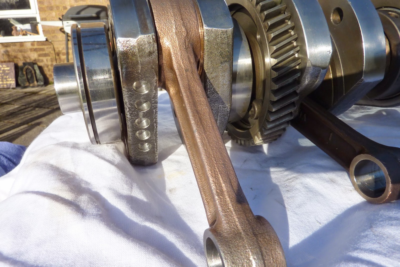

                              Crankshaft Comes Home
                              After about 6 weeks in hospital, the damaged crank from the old engine was returned to me.
                              See My Blog post: Old Crank Comes Home (lots of pics)
                              New big ends, one new rod and 2 new mains, rewelding and a balancing (and why not?).
                              I don't want to put this back in the cases now. She looks so good on my desk.
                              New rod and drilled throws for balancing.
                              and welded back together
