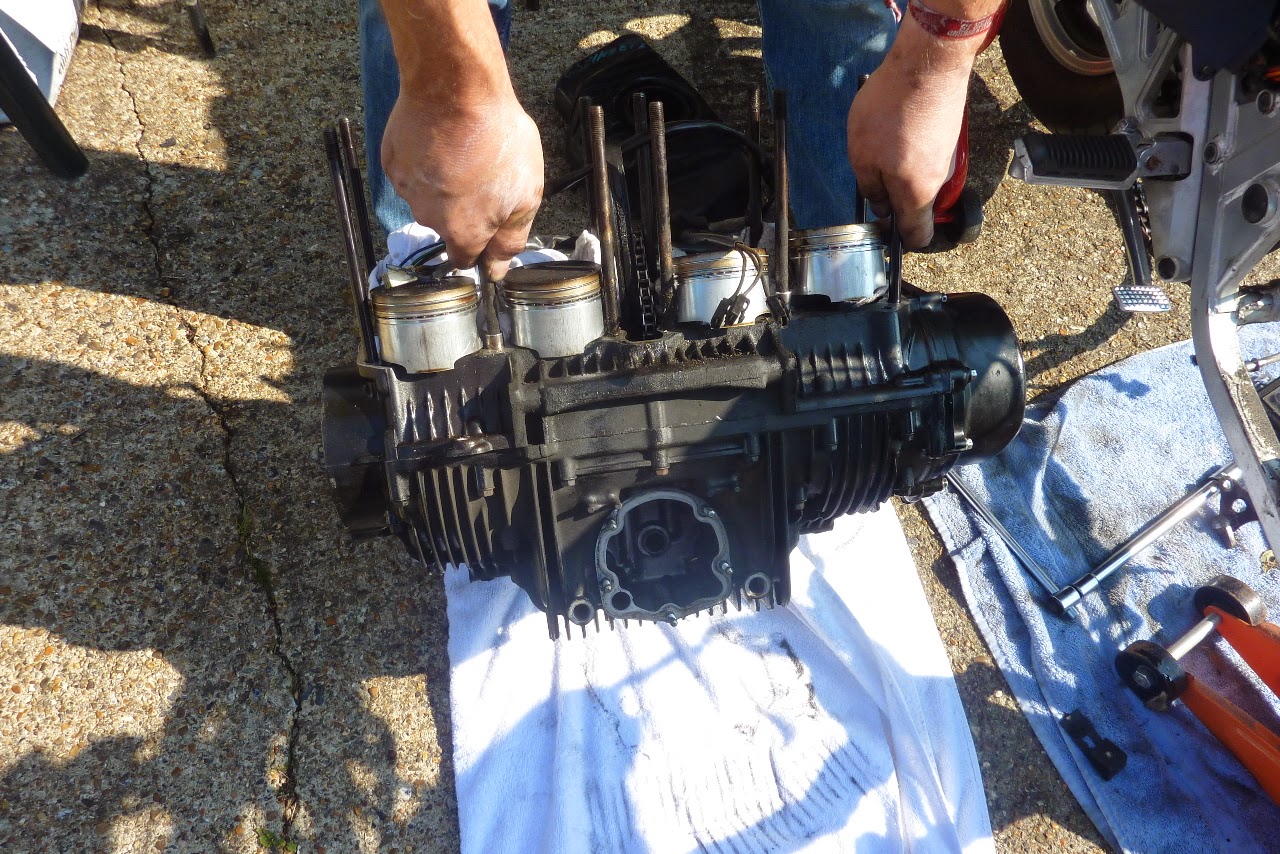

                        So We Are Taking the Engine Out
                        We decided that this motor really needs to be stripped down to check that all the metal bits that have been left in there by the PO are now out and that there is no damage to other parts of the internals. So the motor needs to come out of the frame. A much easier job to do when the head and cylinders are off:
                        Done (with some help).
                        Greetings
                        Richard
                        GS1150 EF bought Jun 2015

                          #117
                          And I was looking forward to another 2 hour video of the struggle of the engine removal Richard!
                          Two points - you need to get your daughter some safety boots for manhandling engines and get rid of that 'sold' sticker on the screen; you're in this far so looks like it's a keeper.

                            #118
                            I wasn't going to mention the "Health and Safety " thing, but you are getting the hang of this engine removal.
