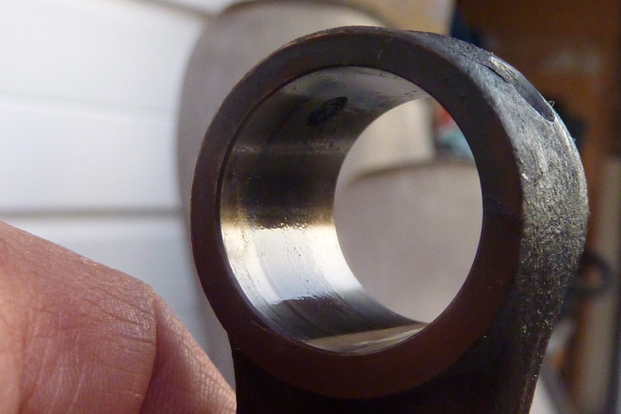

        Overheated con rods with shot small ends:

        Not completely irretrievable. Perhaps.

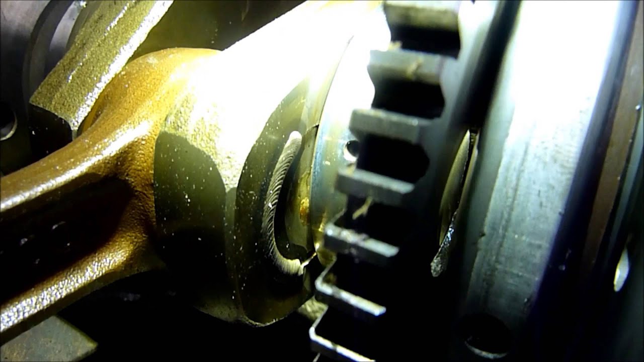

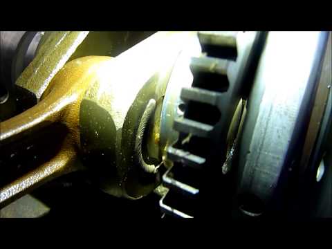

            Having stripped the motor down completely, I was able to see that the metal thrashing around in the bottom of this engine, had inflicted damage on the main bearings and one of them was shot:
            There is no obvious way to fix this so I have to put this engine aside and look at my options.

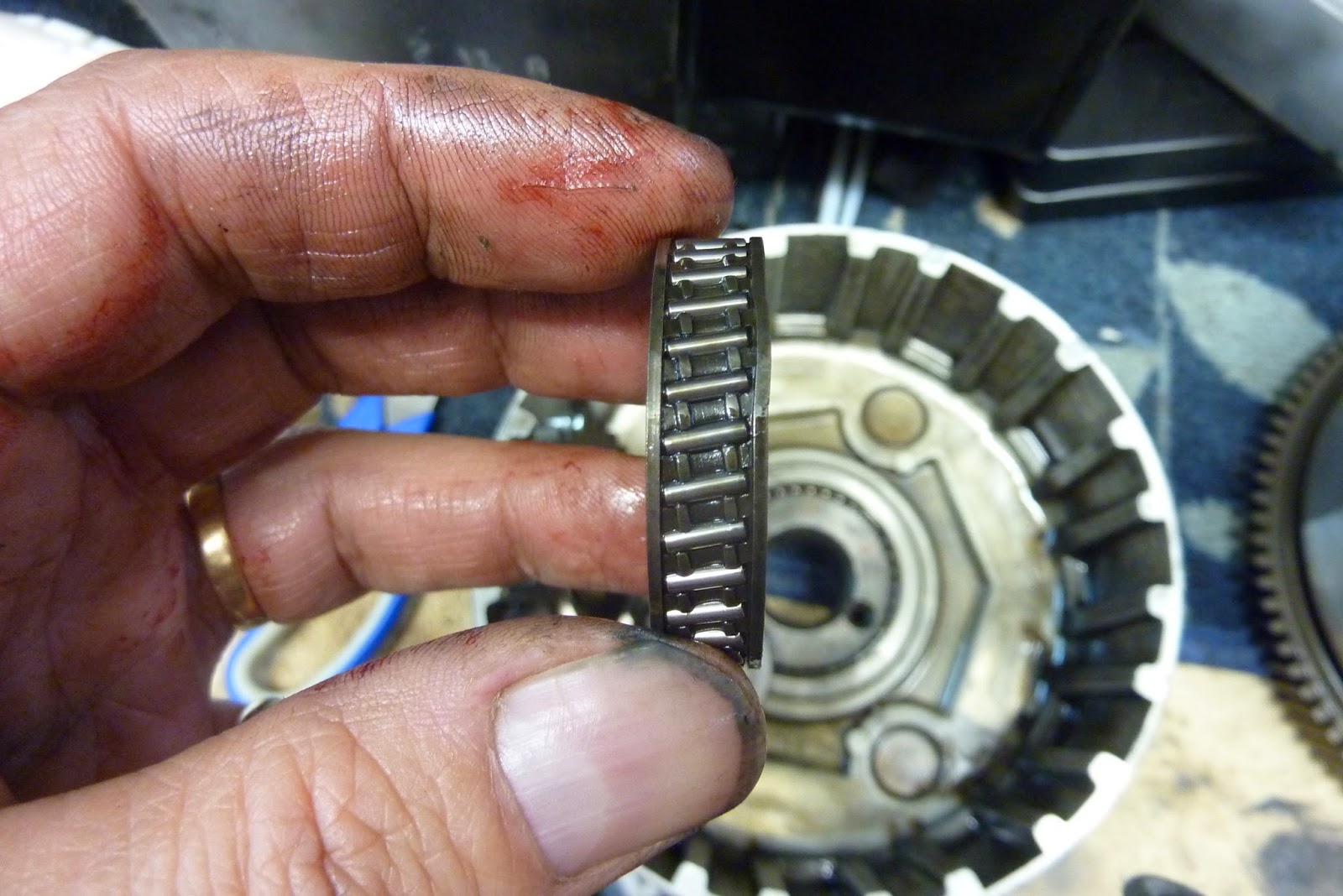

                            The oil pump drive gear roller bearing was trying to go sideways:

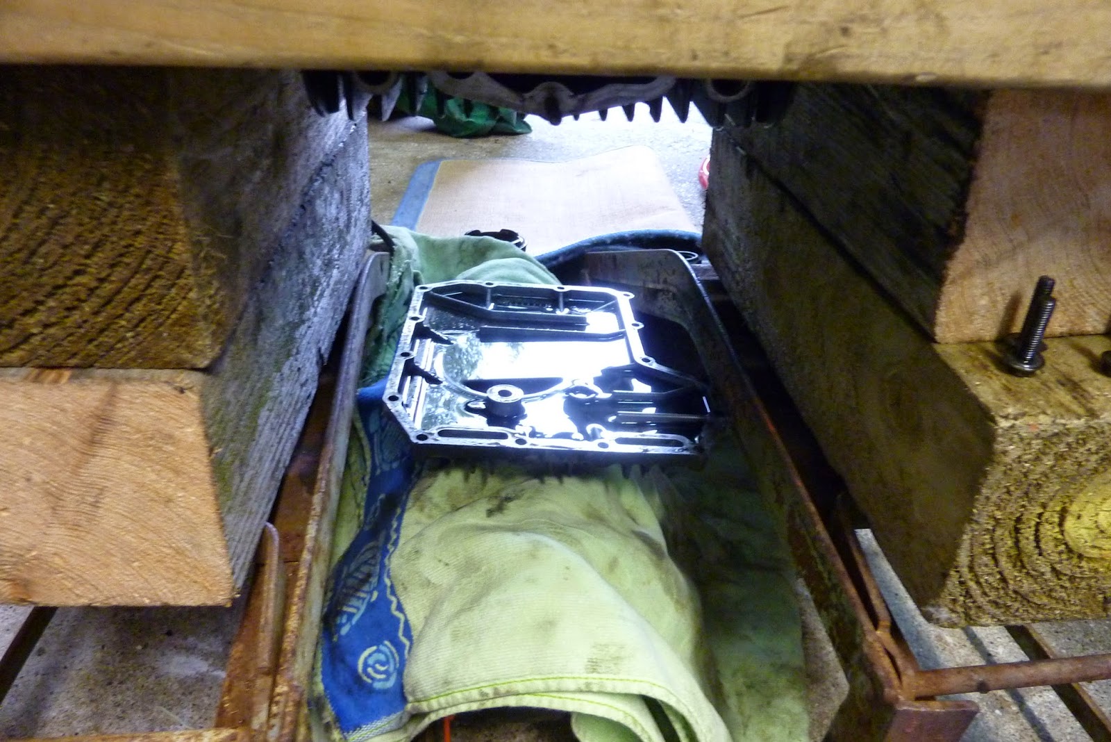

                            So we drop the sump and see what's in there:
                            Actually looks pretty clean. I can't find any iron filings or bits of clutch this time:
                            Perhaps we are making progress.

                              With those marks round the clutch basket and the state of the needle rollers, I would think it's safe to assume tricky van der dicky who flogged you motor was cunning enough to drop the sump and wipe it all out, for sure debris was there. Can you not box it all back up and send it back with a stinging letter of complaint?
