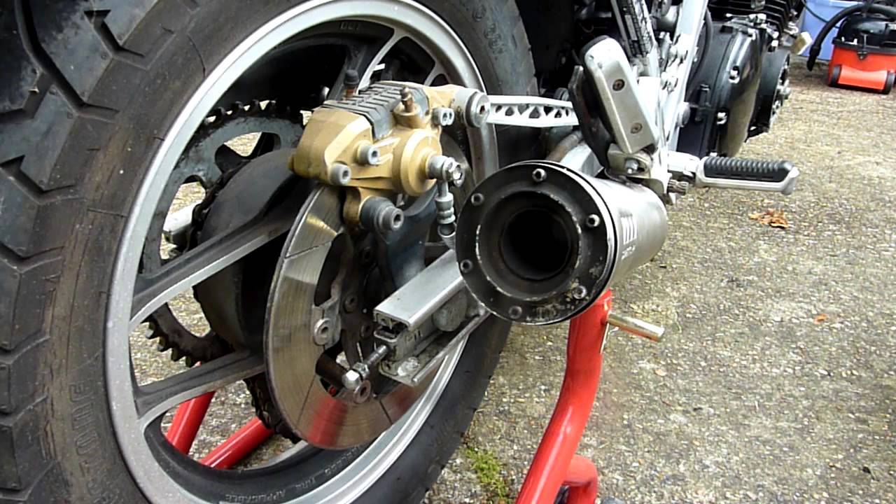

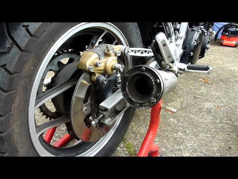

                      We just want pics and videos now please!
                      Here's one I did earlier:
