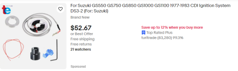

If you're going to run any type of aftermarket electronic ignition run the Suzuki replacement coils that are 4.3 ohm.
Mine are off of the Katana series of motorcycles. I run both the Ebay electronic ignition ($60) and the 4.3 ohm coils ($60)
Also - I don't run the resistor caps. Ignore the "CDI Ignition" part as you will remove your CDI box. This is exactly what I run and have run for over 6 months after blowing out my Dynatek

So I have gotten the Dyna S off ebay (no instructions included and seems like may be a knock off) and am trying to install it, but I am having issues with the magnetic cuff fitting onto the shaft of the advance assembly. In the videos everyone just easily presses it on (after lining up the little prongs of the weights), but when I try to it seems like the rotor isn't the right size or something. The weights feel like they are stuck open, and there is a little wiggle, but they do not move nearly as freely as with the original rotor. I have compared them and it seems like the holes are the same size and alignment as the original, so I cannot figure out what I am doing wrong! Considered shaving it down a little, but also don't want to mess it up and waste $$. It is able to sit all the way down to the base of the assembly, but the prongs on the weights just aren't sitting correctly.
It seems so silly because it should just pop on, but I'm missing something here. I have attached a photo to see if it jumps out to any one.
Thank you!
I fitted one of those knock off dyna systems to my gs1000. I had to lightly file the slots in the magnet rotor to cure the issue you have. It works fine, I added a tiny bit of grease to the slots also.

You gotta wiggle the rotor a bit to get it to snap onto the weights. DONT file on aything. Wiggle the weights while applying a little pressure to the rotor.. I always set the original set up at TDC for 1/4 before disassembly. This way when i put the Dyna rotor on i can visually see the metal pickup bar is facing left. If it isnt them the rotor is on 180 out.
Chuck have you used one of those EBay sets? I haven’t but I wouldn’t be surprised if some minor adjustment was necessary, that’s pretty normal with any China part copies.
I’ve even seen it with brake pad backing plates. :)

This is exactly what I'm dealing with! How did they hold up after a year on your bike?
I ended up having to very lightly file the rotor to get it to fit onto the advancer lobes. Don't be a gorilla, be a mouse. There's no way the rotor would have gone on without filing, though. That's the price of a cheap price.
