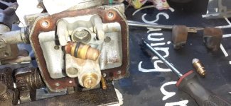

pulled the carbs.
removed floats , needle valve and of course
the tube thing that seats the needle valve
as per pic.
I used to be able to do this with my eyes shut
and forgot about the removable seat ..
anyway new seats don't fit and needle valves
too small. this from ebay years ago.
so old seats and valves back in for now
and I'll order from dealer. but will
risk new tap only.
update :
Only place I can find needle valve and
bowl (seat) is cmsl 38? each for
valve and seat per carb.
I hope a clean up will do and new
tap. Mad the price if carb bits!
