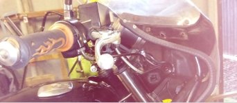

As I'm using my GS550E in the cold and wet British winters, I have managed to find a 1970's/early 80's Rickman's front fairing for the bike. This should help protect me and the bike against wind and rain and make the bike more usable during the winter months.
The fairing I bought was originally fitted to a GS850 I believe. I have fitted this and the frame fits, as does the fairing. The only trouble I am having is that the handlebars on my bike are not the originals and they catch the fairing when the wheel is turned as they are too high - and so I need to find some new handlebars.
I have been told that low rise handlebars would be ideal as this would reduce the height and allow the handlebars to move freely with the fairing fitted. I have attached a few pictures which may help to explain my predicament!
My question is, does anyone know what handlebars came as standard on the GS550E, and if so could you possibly provide measurements or a picture. If any members have fitted a front fairing, I would be very grateful of any pictures which show the handlebars and fairing in the same shot.
Luke, I have some standard bars here which I'd be happy to measure. Might take a day or two, as I've damaged my back and can't currently reach them!
But looking at your photos, I'd say you need flatter than standard. Yours are maybe a little higher than standard, but not much.
I don't suppose you have a length of 7/8" tubing? You could lay that across your handlebar mounts, and use that to determine desired pullback, height etc.
Hi Steve, that would be fantastic if you could measure them for me. Great idea about the bar - I might have to cut a broom handle and use that as a measure of whether or not straight bars also catch.
I'm wondering if Rickman's supplied some drop handlebars with the fairing at the time. It is obvious that the fairing is designed to have handlebars which are much lower.
I really want to get this sorted!
I have been looking on eBay and someone in the UK is selling NOS patter low rise handlebars, the trouble is I think if anything I need bars that drop an inch or so rather than rise!
Look forward to hearing from you Steve! Cheers Luke

What Steve and buffalo said. Rickman 95% of the time came with very low mounted clip on as they were a sports/racing platform.
You need swept back drag bars (no rise but not the straight broomstick kind), Superbike bars (2" rise or so with moderate sweepback), or some clip on bars like tomaselli's that are adjustable.
I've seen a few photos of Rickman CR's with original clubman bars mounted on the triple, & one with Superbike bars - which just looked odd for a Rickman since they always have an aggressive stance.

Yes I'd say that needs clubman or clip on bars! Can you modify the mounting slightly to raise the fairing any? Then you could fit drag bars possibly.
Thanks for the advice, the fairing will not move at all from the position it is in unfortunately so I guess this means bars suggested in your post Chuck78.
